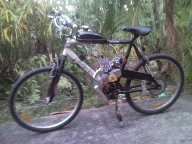

Built my first bike... and can't stop riding it, totally awesome.
I'll try to add a picture...

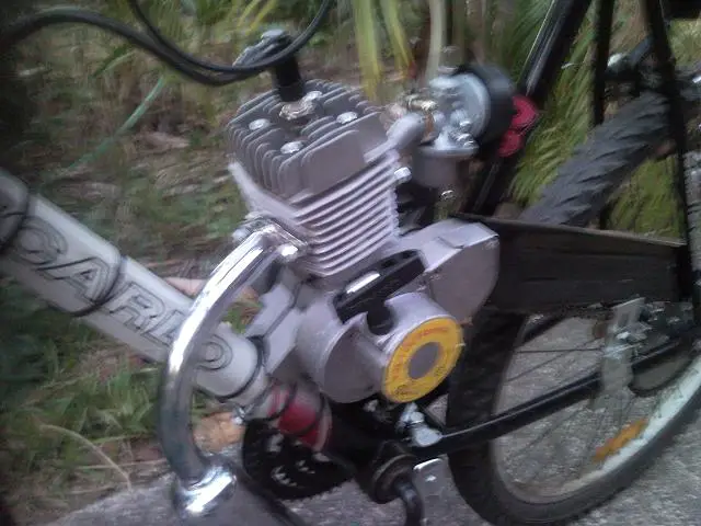

This is a 48cc auto kit with pull start
I could not fit the motor to my first bike would not fit into the V so I got this bike from the dump shop for $20 aus, and all i bought for it was a new seat and stand. It took me all weekend to fit tho

Nice bike for $20 no doubt! You got it all together in a weekend? If ya get the chance could ya post a pic of the pull start arrangement? *shrug* Just kinda curious

Here you go buddy...
You can buy the pull starter on ebay for about $20

Cool, been kinda thinkin' bout gettin one so I can start my bike to warm up in the morning w/o havin' to pedal across the lot lol
Thanks man, any probs w/pedal clearance?
Oh and I can see what it only took ya a weekend to build yer bike - lol it looks like it's made for it!

I have two pull start motors, one is pull start with a manual clutch and the other is pull start with automatic clutch. I love 'em for the very reason you mention. I had another engine I bought a pull start kit for from BGF. It cams with no instructions, of course, and could have used some. There is a clearance issue with little headed screws behind where the pull start mechanism fits... on factory pull start engines the screws are different and there is no clearance problem. Right away I broke a plastic piece inside the pull start rewind setup. Got another for free from BGF and this time went to work with the dremel tool grinding down the screw heads and slotting them. Worked fine for about an hour, then the retaining nut came loose and the pull start was wrecked. If you do the conversion, take your time, make sure you have clearance and that everything is firmly attached in there. Others have done it successfully and you're more mechanical than I am, so should have success. I think it is real negligence to not supply instructions with how to make the conversion successfully photos. I did have to go with a shorter crank as there was a clearance issue. Having the pull start is also nice when you're working on the bike, have it up on a stand and want to adjust the carb, for example. (Not that there's much to adjust on these carbs.) There are times when it is very convenient. For my own rides I now want them.

Thanks for the warnin' silverbear, I prolly woulda just bolted that sucker on there and been a touch irritated when the recoil... well didn't o_O

Yes... as you may of noticed there’s no bike chain or derailers
the auto kits are allot wider than the clutch models
about 4''... 2'' for the centrifugal clutch and 2'' for the pull start.
This photo was taken after I completed the build (about 3 weeks ago) since then I have widen the crank and added the chain and derailers. Also added a free wheel on the motor side gear... to make peddling easier, but don't do much peddling any more
I also added a in-line fuel filter as well (worth its weight in gold)
I took my tape measure with me when I went to the dump to make sure that I got a frame that would fit the motor... I seen reading other posts that allot of guys have trouble with clearance for the carbie, I had the same problem with my first bike that I bought from Kmart and found it easier to find a bike that I would not have to modify to much. I was originally looking for just a frame and saw this one. The guy at the shop wanted $15 for a frame and I asked him how much for the bike and he said $20
