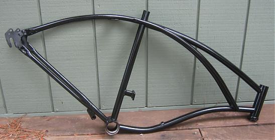

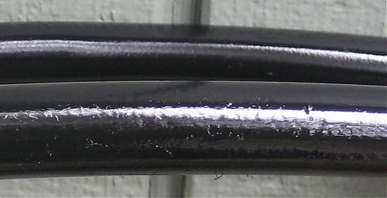

First picture is the worst part, the area that had the most rust, but as bad as that looks, seeing it from a distance (2nd pic), as those I pass will see it, the bike looks fine.

Looks good to me. I like the welded motor-mounts, I would like to do that with my Schwinn, but it would be impossible to match the paint. Have you run the bike with those motor-mounts? I think that is one of the most important aspects of keeping the vibration away. Have fun, Dave
