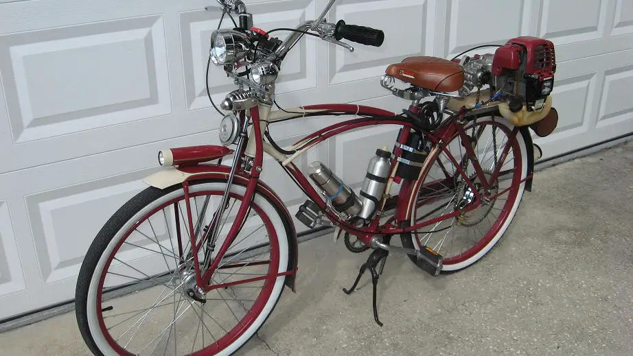

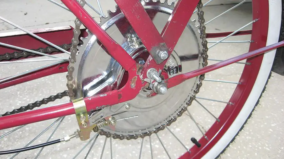

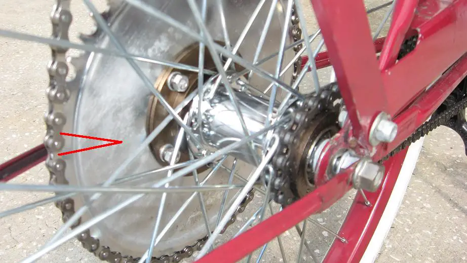

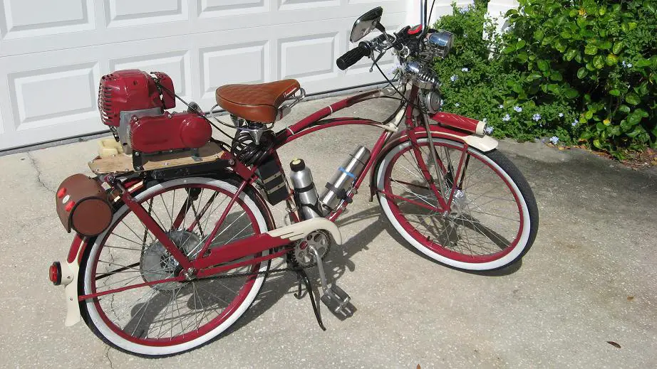

OK, as promised here are some pics of my new wheel/hub setup.
Also, my (unpainted) rack mount CVT. I need to do a lot of repainting/touch-up since fine tuning
requires many times of moving and removing stuff. Some of this was previously used with a different
rack too.
WC
I forgot to mention the two red lines on the large rear sprocket. They were just to point out how deeply and fully the BMX chain seats on the sprockets.

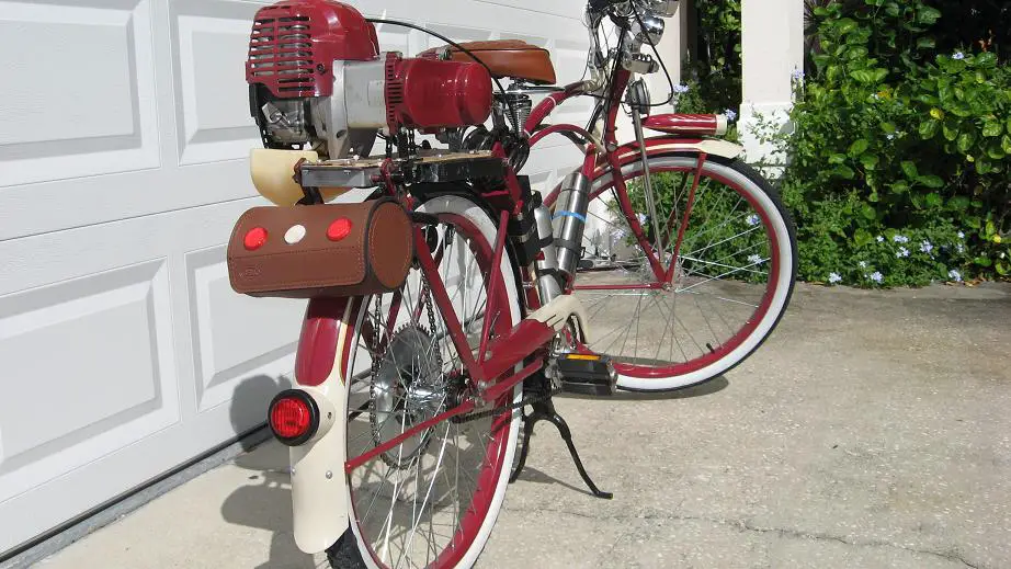

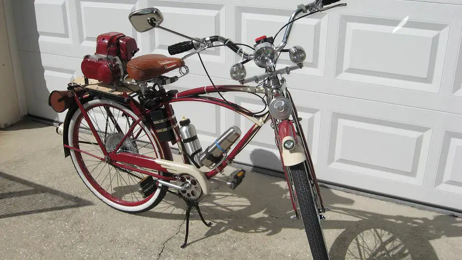

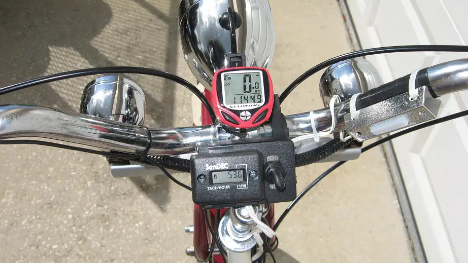

Here's a few more pics of the whole bike.
#6 is my Tach and Speedo. Note this is the actual miles on my CVT. It's holding up well.
Coming soon will be an instrument panel with Volt and Amp meters.
WC
