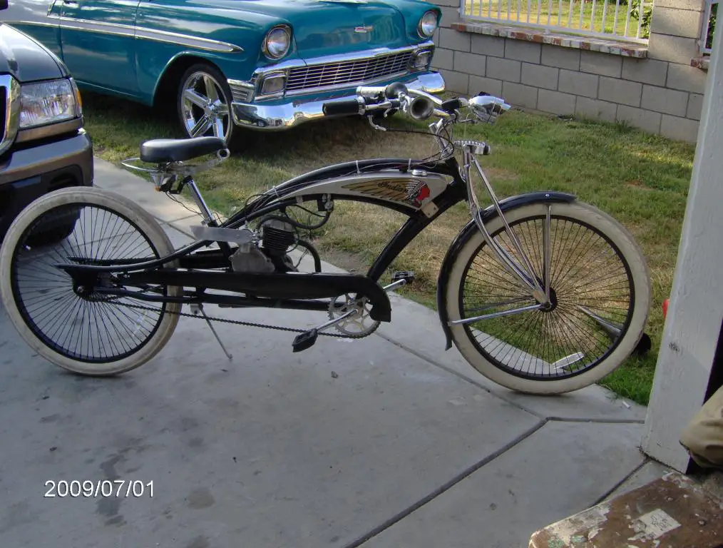

Who wants the first one? very fast 35 tooth rear/s it has 66 cc motors, led head & tail lights, led turn singals, horn, mirror, custom stainless steel tank, slash exh. pipe louder but sounds great. other options availible like disk brakes and billet rims powder coating any color ya want. Ya want a sweet ride to make heads turn, everytime I ride it people go ya ya over it, what is it? did ya build it? etc. I like how smooth it runs, the chain ajusters and rubber mounts make a big differance I'll have a red powder coated one done in two weeks. call me if ya want a custom built bike E J call me I'm in OC Calif USA 310-738-0136

Im planing on building my own stretch cruiser this winter, i already have a cruiser with the 80cc. i just wanted to say that your gas tank... Marvelous! Keep up the good work

I want that Chevrolet in the background !

I WOULD LOVE TO BUY A TANK LIKE THAT WHO MADE IT FOR YOU .....????????

very nice build! ITS KNOW WONDER YOU HAVE TURNED HEADS, THE TANK SPEAKS FOR ITSELF well keep it up someone knows about builds will it

Any Motor bike will turn heads anywhere, don't matter if it's a stretch or stock Walmart cruiser with a motor on it. I wonder if the "Custom" work includes welding gussets on the frames. I know we had too, built seven {7} stretches already and in time they will crack in some spot. We've used XYZ, Macarge, and Sik frames- most cracked after several hundred miles. We welded the cracks and added gussets in different places. Some got gussets and some just got repaired with welds. Personally, I pretty much only ride my stretch cruiser and I just sold one to a buddy, although still putt my 26" MB mountain bike. Alot more care with chain/tensioners is required for a stretch cruiser.
