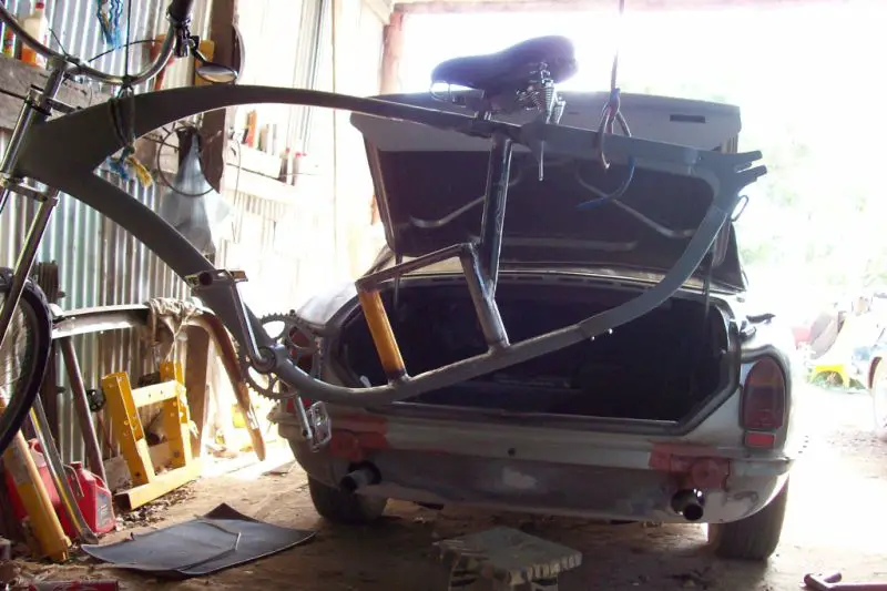

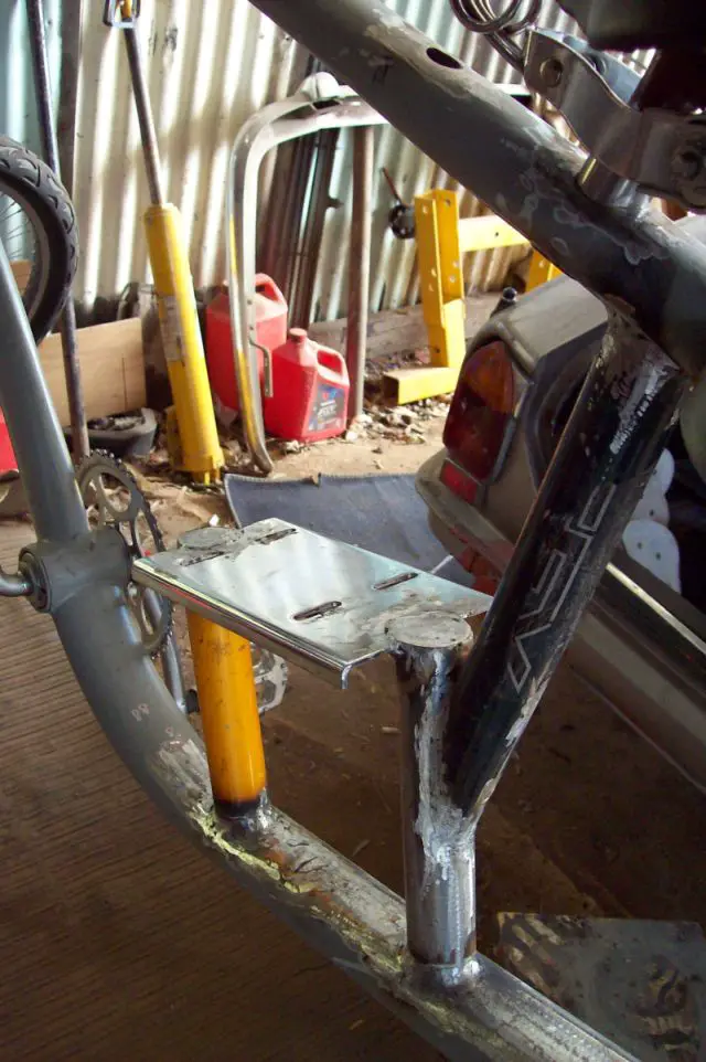

Spent the last 3 days trying to mount new 4G Four Banger , after a few attempts this is what I have arrived at , the seat post came last , the original post went further forward ,anyway still have a few more small gussets to weld , Had a lot of trouble trying to get the motor as far back as possible , Im quite happy at this stage with it all , More later.

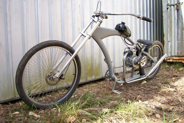

This is the new version ,I like it way better like this , the bike does everything better now .

nice looking ride, looks like it has plenty of leg room!

I love that bike! Good job!

Very, very nice indeed. Great Job!

nice build
tank looks sweet !!!

Many thanks everyone , she needs a centre stand , looking amongst my junk for a suitable spring .
