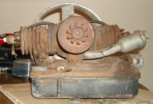

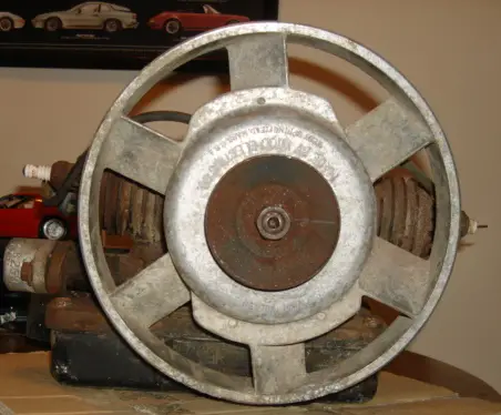

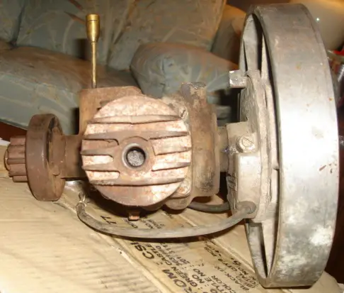

Picked up a this motor on ebay, with plans to attempt to install it on a Moon Dog bicycle in the frame if I can make it fit... I am going to lace a whizzer sheave to the rear wheel. The motor produces 5/8hp at 1600 rpm, I plan to make an expansion chamber for it and possibly a different fuel system.
Here is someone elses install:
YouTube - Maytag Bicycle
*He eliminated the factory coil and is using an accel cdi.
*Dont know what carburetor he is using
*He removed the gas tank, flywheel, and kick start system, but installed a homemade flywheel on the opposite end of the engine
The motor I got has some play in one of the bearings so I will probably tear it down and rebuild it.

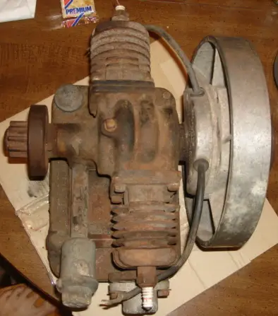

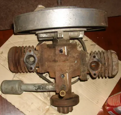

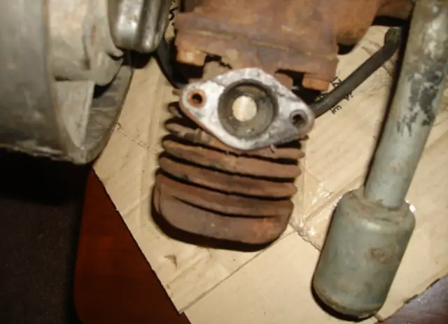

here is more pictures of it mostly stripped down to the size it will be installed as, it is maybe only a couple pounds heavier than a chinese motor. From cyl head to cyl head it is 11.25" & the total length of the crankshaft is 12" but could easily be shortened to 9.75" when the starter end is removed... the height of the crankcase is 4.75", not counting the fuel intake which will be modified or removed.
Look at the tiny exhaust ports on this thing maybe some port work can get 1 hp out of it
