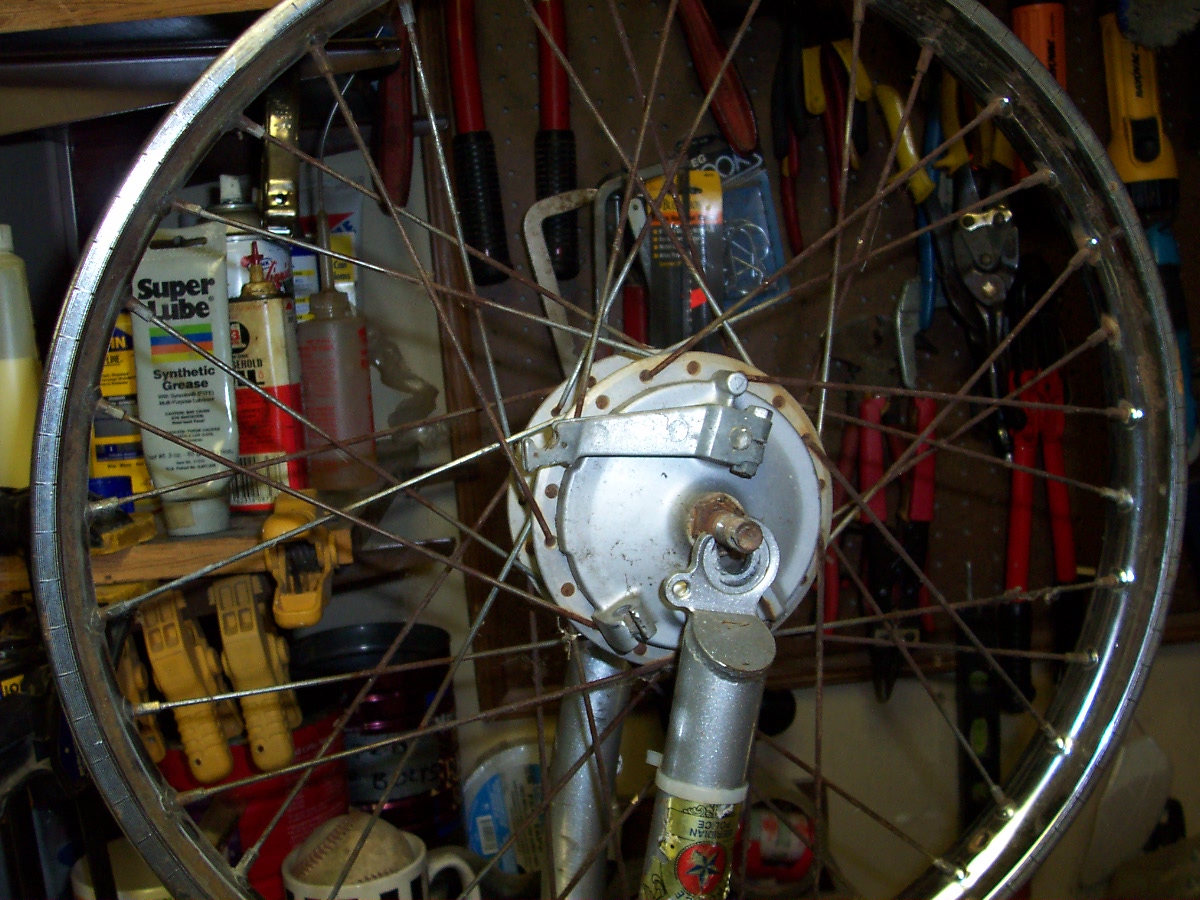

Find an extra fork and clamp it in a vice. Put a couple of zip ties on the fork, one for lateral run out (cut it so it's a little longer then you need to touch the sprocket then turn it so it just barely touches) add a second zip tie and leave it just long enough so it doesn't touch your spokes and position it so the teeth of the sprocket just miss touching it.
Not a bike wheel but here's mine so you can get the idea.

Um... i'm a complete noob and I didn't understand anything you just said there... :/ Also i'm confused with the picture...
