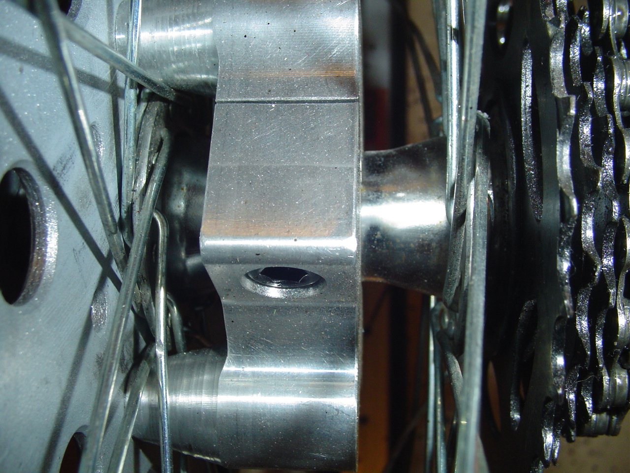

Hello to all! I'm currently working on my first build with a china 68.5CC. Hey why is it called an 80?I havent been able to find that out yet... Anyways back to what I originally had. I got the kit on and it's taken me a long time to get it going. Everything had to be fabricated. I had to make new mounts for the down tube and the seat tube and cut everything but the one thing Im havin the most trouble with is the sprocket! It wobbles no matter what i do. I noticed that the rubber packers it came with were bend when i got them, and even had a little material missing from one side of them. In order to get less wobble, i have one side cranked down and the other side barely tight?? Anybody have this problem? I don't trust it over 10mph b/c it will take the chain over the side of it and tighten the chain up yanking on the motor and chain tensioner. As of right now, my hopefully good cheap form of transportation is very unreliable. I got less than a mile before it jumped and i had to walk home...

unsure what u mean, does ur hub fit through the center hole in the sprocket? ur sprocket has to be straight.

You mean the rubber spacers? I found that one of mine tapered down to one side but the other was pretty flat. Put the flattest rubber between the sprocket and spokes then use the worst one on the inside of the wheel where it doesn't matter if it's flat or not.

Your problem can best be solved by ordering a Aluminum Machined sprocket adaptor from Jim at Manic Mechanic parts, right there in your home state of Florida. Believe me, I have ordered several and they work perfect!
John
