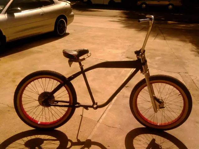

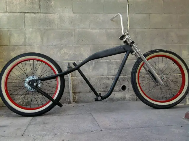

Photo #1 Here's what I'm starting with, A Felt -El Guapo cruiser...
This was a motorized bike that I bought used for $200. to fix up.
Now, I'm gonna chop it up, stretch it & lower it!
I'm not sure I want to rake the front, because the top tube is very thin steel, & we've had problems with cracking frames from riding them hard & fast!!
Photo #2 This is a quick scribble of what I got in mind...

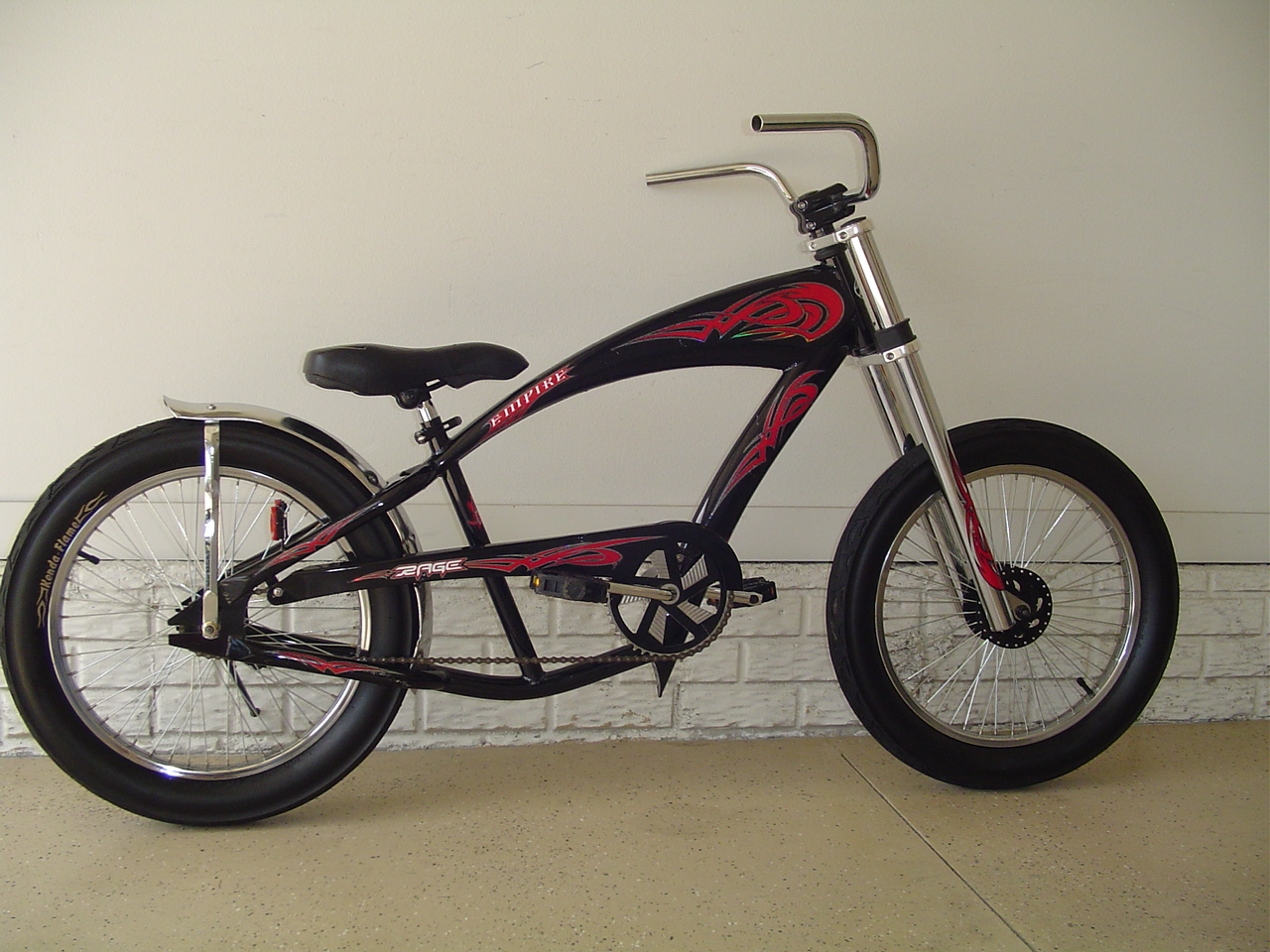

Here is what I am starting with. The finished product is going to look a whole lot different.
John

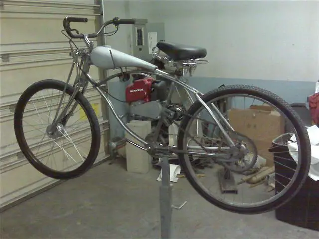

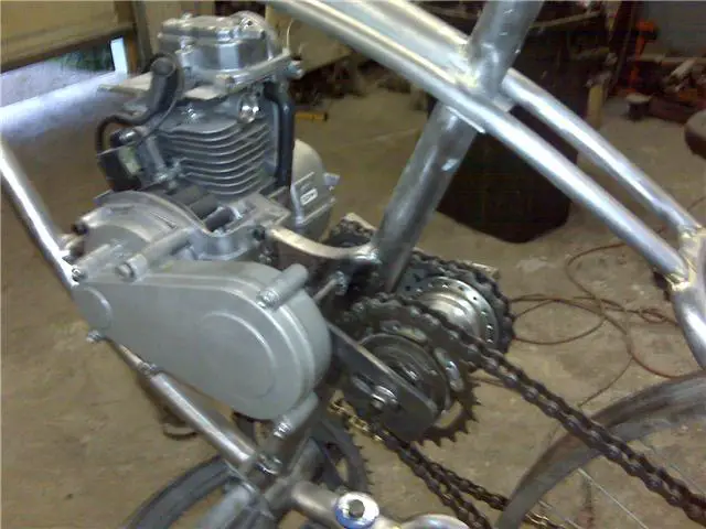

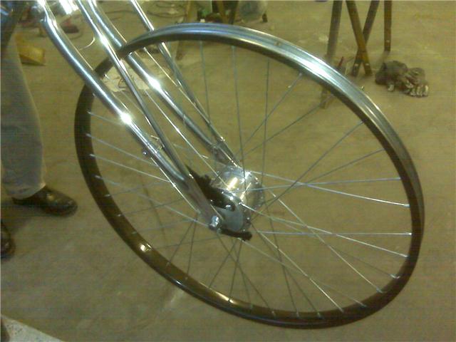

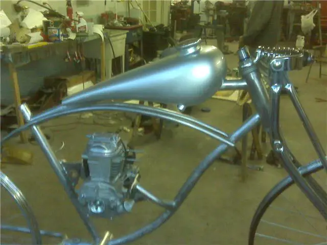

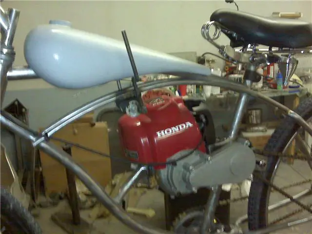

i'll post up some pics later, i'm at work right now, but heres the low down on my build.
the frame is a 60's columbia boys bike, it will remain stock, striped to bare metal and polished, then gun blued and sprayed with clear. i'm using a front drum brake wheel with 6V dyno hub. schwinn springer fork, custom gas tank and fenders. a GX 35 honda 4 stroke engine mated to an intermediate 3 speed hub jack shaft as a transmission with jockey shifter. coaster brake rear wheel.
to add updates to our builds should we edit these first post, or will they be strung out through out this thread. also something we might want to do is run a raffle, the winning bike go's to the winner of the raffle and the proceds split 50-50 between the winning builder and a charity.
heres some pics so far

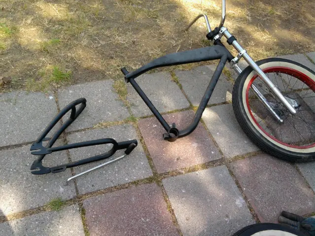

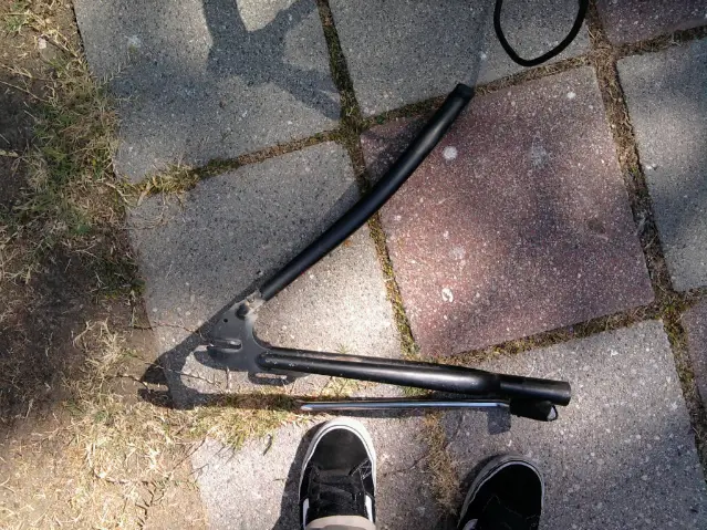

Here's todays progress...

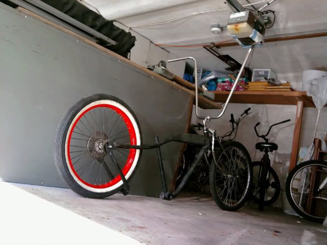

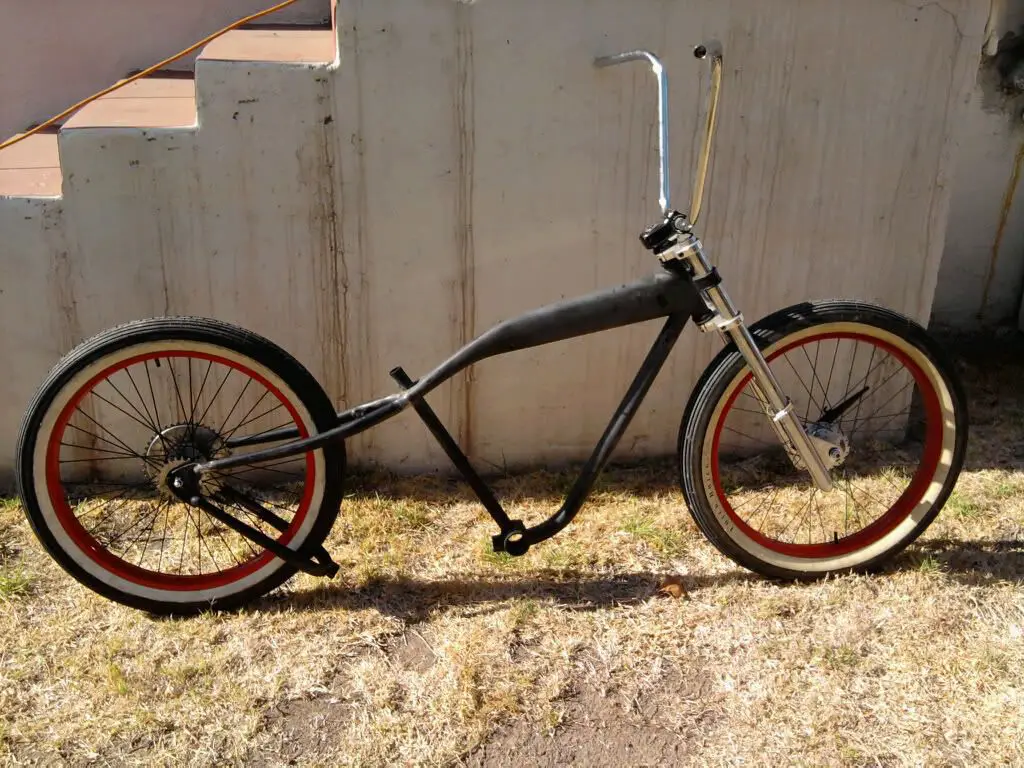

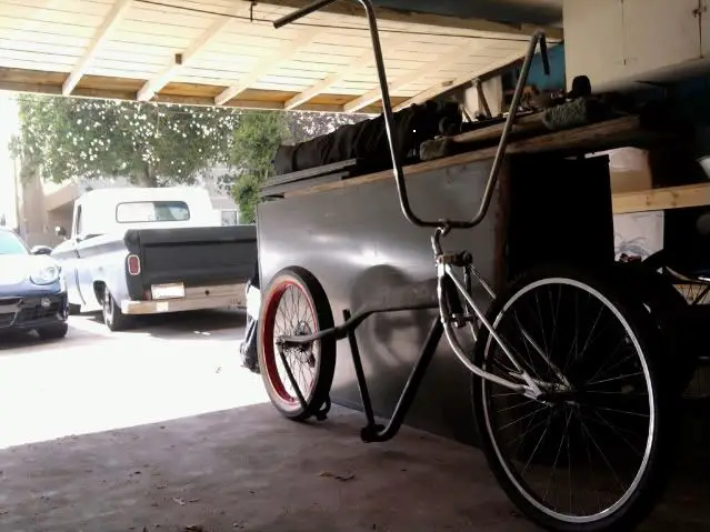

Photo # 1, I cut the frame in half.
Photo #2, I cut the top chain stays from the dropouts & flipped them over & rewelded them.
Photo #3, I welded it back to the frame... Next, I'll work on relocating the BB & getting the front end down on the ground!
Photo #4, another angle.
I'm kinda 'in limbo' on building the bottom end of the frame until my new fork gets here.
I have to see where the final ride height is gonna be before I can build the lower end.

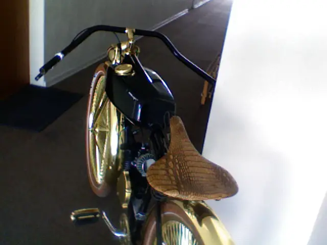

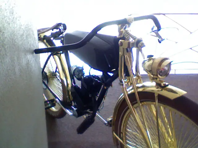

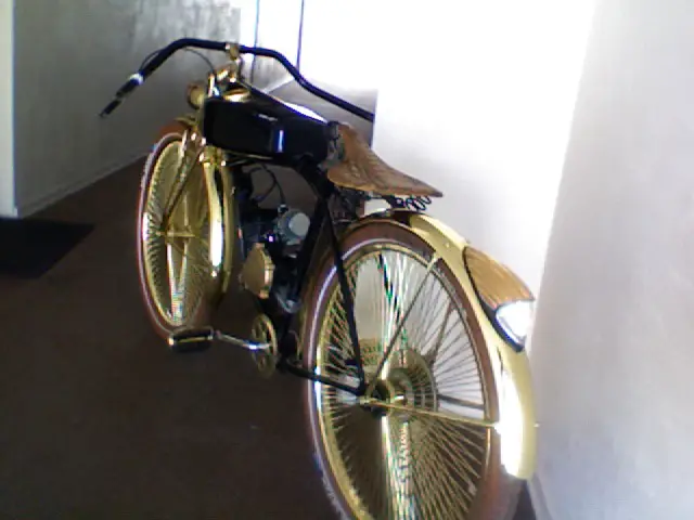

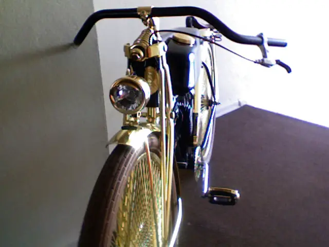

Here is my Gold Indian.
!974 Indian tank
1918 gold head badge
Indian Scout fender light
Gold plated crank
Gold plated fenders
Gold plated stem
Gold plated head light
Gold plated front end
Gold plated crate pedals
Gold plated 144 spoke rims
alligator seat
Still needs the chain, leather grips, brake, gold Indian decals before clear coating and black treads.
