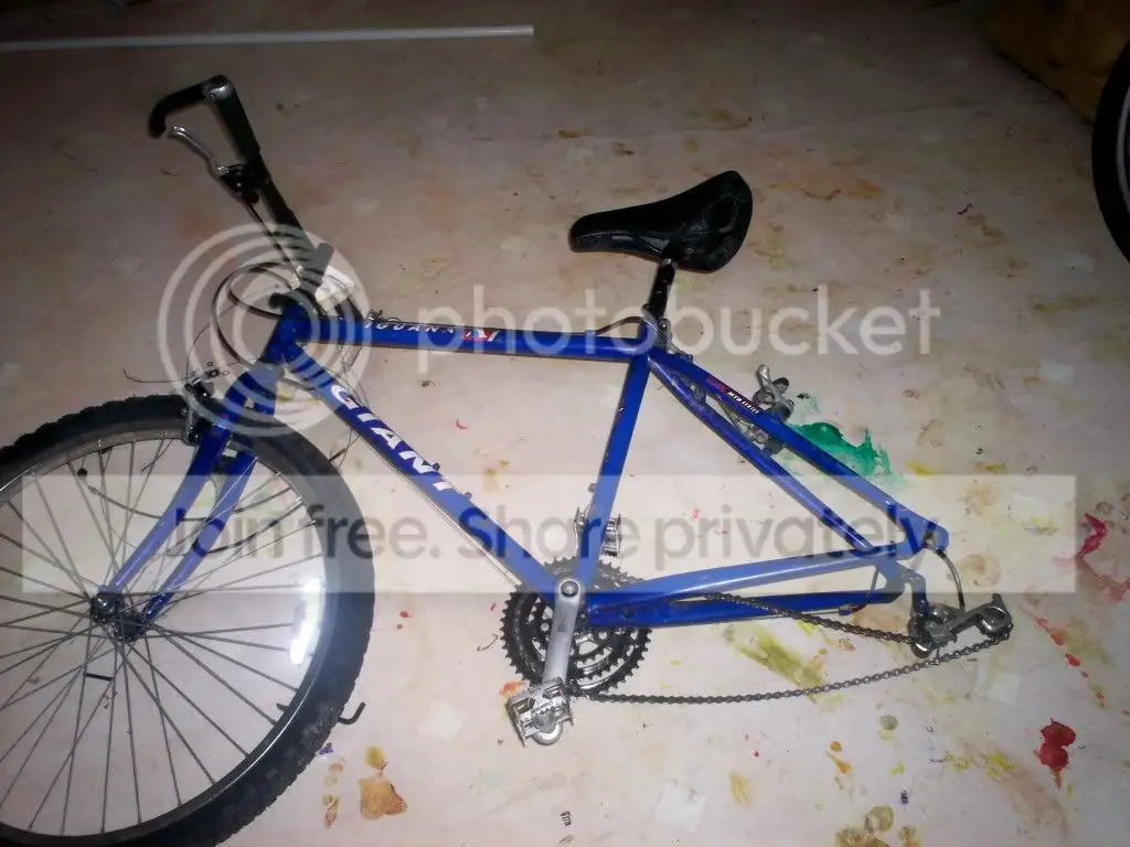

frame 1: giant iguana
frame 2: giant acapulco
[IMG]
which one- iguana or acapulco, and why?

The Iguana looks like it would be a little tight.
I would not use forks that were repaired with a hammer.
It is a little tight but it fits. About not using the forks that were repaired with a hammer, why would that make it bad to use? I biked around town with it after hammering the forks and nothing seemed wrong. Hammers are fun. bang bang bang oopS!

The metal gets fatigues from being bent, then again from hammering back into position. They could break and then you will have a face plant situation happening. When you ad an engine to the bike you are increasing the speed, and vibrations now come into play as well.

Aside from the fork issue, is a tight fit a bad thing?
Here is another pic. [IMG][/IMG]

For a minute, I thought you were mounting up a new sort of a wing or something there.
A tight fit is a good thing, as long as it's not too tight. Too tight makes thing less fun and more like work with the end results being about the same.

i would use the green one, just because of the rear drop-outs (the slots your back wheel sits in.) since they are lateral, the wheel can slide back and forth so you can tension your chain(s) better.
the blue bike's vertical drop-outs cancel out any chain adjustment.
and i would NEVER ride the forks you repaired with a hammer, unless it was the only way to get home.

I have found that a bike frame that fits me well for mountain biking (pedalling) is too big for me when motorized. A tall bike is OK when riding in spandex (under my baggy shorts, of course). On the motorized bike you will be in street clothes and don't want to rip your pantalones.

A tight fit build can be an obnoxious pain, however if it works I think it looks more like the motor is supposed to be there and less like an afterthought...
...and I just like blue
Although I too wouldn't ride rebent forks, that's really not much of a problem as you'll find you may want a suspension anyway. While nice suspension forks can go for a pretty penny, check your local bike shop for take-offs. Many folks upgrade their front shocks when they buy a new bike and leave the stock ones at the shop. Many of these are of acceptable quality - they just wanted crazy downhill ones or w/e.
My local shop sells these for as little as $10, though I'd spring a whopping $20 to get ones with disk brake tabs
