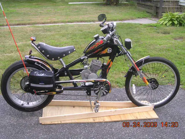

I got tired of my butt getting pounded by my stingray seat. Looked around the shop for for what I had on hand fo fix the situation. The result worked out well. I mounted a hinged plate on the seat post with two tennis balls between them and remounted the seat. Very comfy ride over rough roads.

thats sweet! how is your light set up?

Main light runs off of a sla 4ah batt. Backup headlight (56 led) runs off self contained batt. Turn & brake light run off self contained batt. Am installing v-regulators to get rid of self contained batt. system is trickle charged off white wire with aux 110v charger(removed from emer-light).
