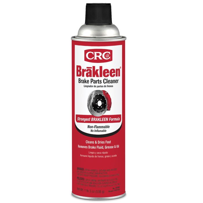

Decided to clean all the gunk off my engine the other day so I grabbed a handy can of carb cleaner and had at it. Cleaned the gunk off really well but after about a minute anywhere I'd sprayed with it the paint started to wrinkle up. Let her sit for a few hours hoping the paint would lay back down and it did but I think a better alternative would be to use brake cleaner.
Carb spray is best left to cleaning bare unpainted parts off the bike.
Brake cleaner would be a much better replacement for carb cleaner for doing leak tests and general motor cleaning plus it's cheaper just keep it away form anything plastic.

Yep- did that too :-(
Thinking about it, doesn't brake cleaner eat paint as well?
Might try WD40 or something like that next time.

No, brake fluid does but not brake cleaner. Well maybe on fresh paint but it is a lot gentler on painted surfaces then carby spray.
