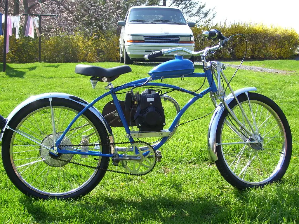

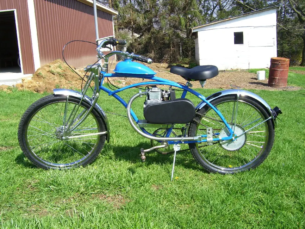

I have an EZ & love it. It just goes with no maintenance. I must admit that I took my outer cover off a few times to check it & just put the cover back on. At about 500 miles I replaced the front belt. $8.00 & 30 seconds. Just runs great. I have the manual clutch & rode a Q-matic auto clutch at the East coast rally & it was really smooth too. Here's pictures of mine.
