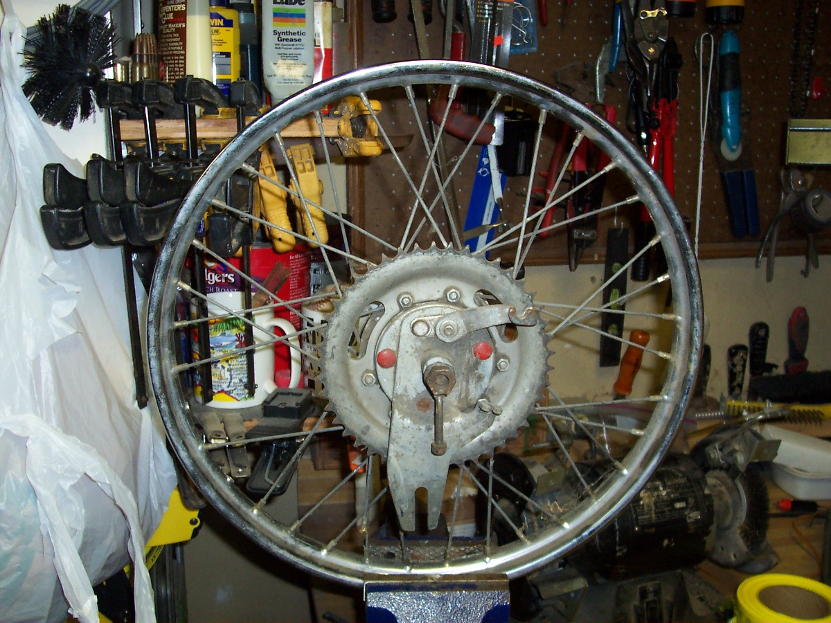

Was wondering if anyone has ever had a sprocket re-cut. I have a moped hub that I want to use, it has a 44T and I'd like a 36T sprocket but I also want to use 24x3" Thick Brick tires. From my rough measurements any sprocket I use will have to have the offset that the original one has so the chain will clear the 3" tire and finding a replacement will be nearly impossible since I don't even know what this hub came off from.
Could I just take the sprocket to a machine shop and have them cut it down to a 36T?

A 44T has an outside diameter of 7.29" A 36T has an O.D. of 6.015"
I can't really tell for sure from the pictures, but it looks like it may be close. Lay a 5 1/2"" diameter circle on your existing sprocket to see if the re-cut would end up in the dished area...If not I can re-cut it for $15.00. Clamp it...indicate it...call-up tool #2 and done!

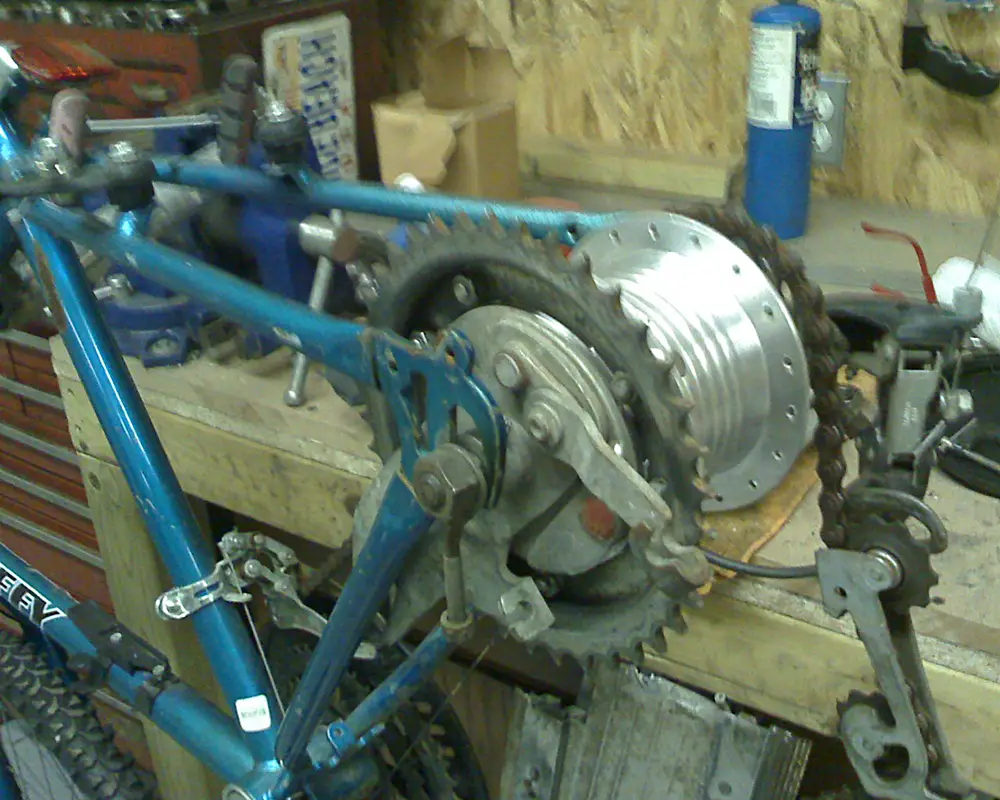

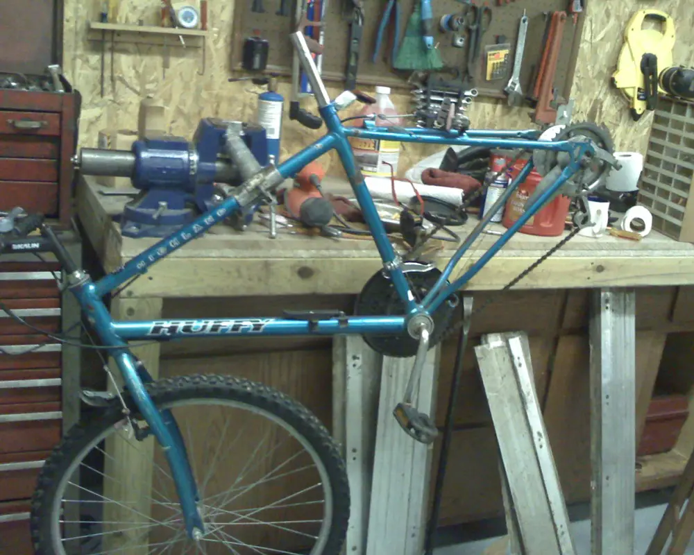

Thanks for the link bairdco, just got the sprocket and it was a perfect fit only problem is it ended up being a 38 not a 36 as the seller described but after looking at it closely I don't think you could get a 36 and have the offset.
There would be no way to re-cut the original because 5 1/2" ends up being inside the slots on the sprocket.
Hub fits pretty well too. Test fitted it on an old MB frame that may or may not end up being the starting point for my BT build. A little grinding on the dropout and some widening of the chainstays with a 2x4 it drops right in.
