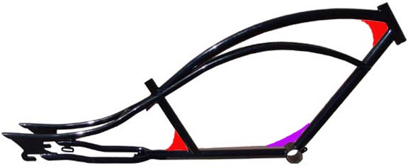

Bill,
Studying that frame but not knowing your weight and the riding surfaces you usually travel, I've added a couple of gussets where I would add them if I were building that bike. The red ones for sure and the purple one unless you can incorporate some strengthening in your motor mount. I'd probably use 1/4" plate but 3/16" would suffice, I'm sure. That is an interesting looking chassis and should make a great looking cruiser. Keep us informed.

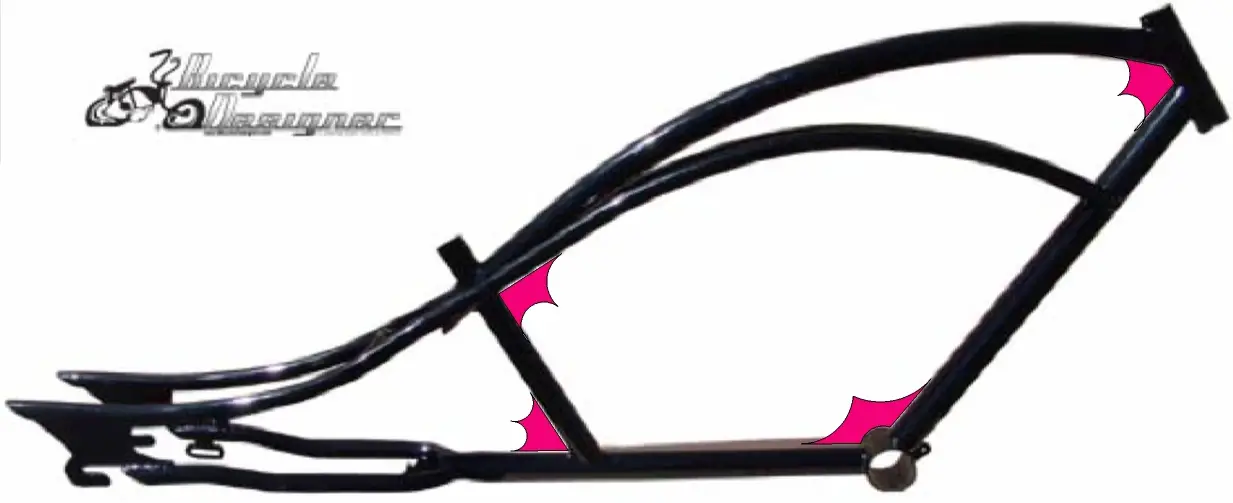

This is where I would gusset it.
:edit: Dammit! I'm too slow!
But my gussets are fancier!

I am 145lbs and always ride on smooth bike lanes
thanks
