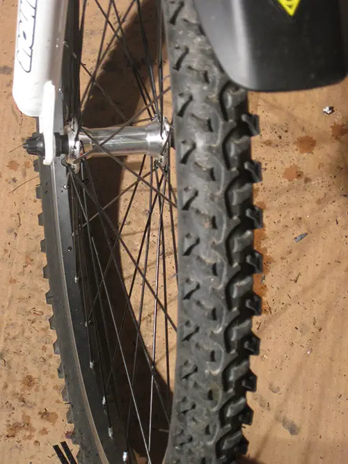

Tires - knobbies are fine, they slow you down jus a little but if you're careful to pick out a set with interlocking center tread the ride is smooth and wear is MUCH less. (see pic)

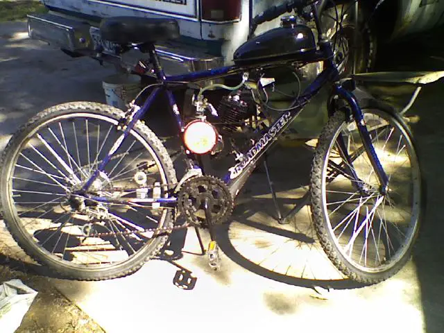

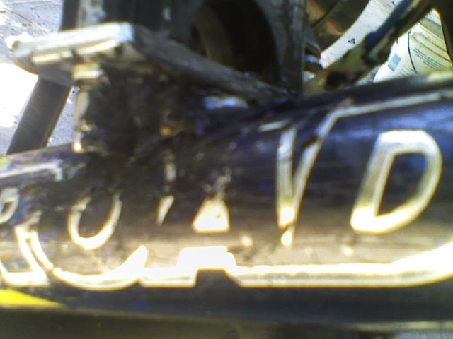

My sentiments exactly...ya drill for oil not motor mount LOL I used black rtv rated at 450 degrees and it seems to be holding fine. The pic is a bit out of focus but I just squirted a bunch under the plate they give ya if the clamp don't fit with the nuts from the studs resting on the frame. It seems to be holding fine.

Sorry G, the second pic isa bit blurry, how did you do your front mount?
Nice build btw - I like mountain bikes for this. Nothin' wrong w/a chopper or cruiser, just the roads around here are so rough they might as well be the trails I like to ride so much lol

I bolted the plate up to the bottom of the motor (there are 2 nuts at the end of both bolts) the nuts at the end of the studs rest on the frame's bottom cross member and I filled the gap between the studs under the plate with black RTV gasket matterial. It is holding fine.
