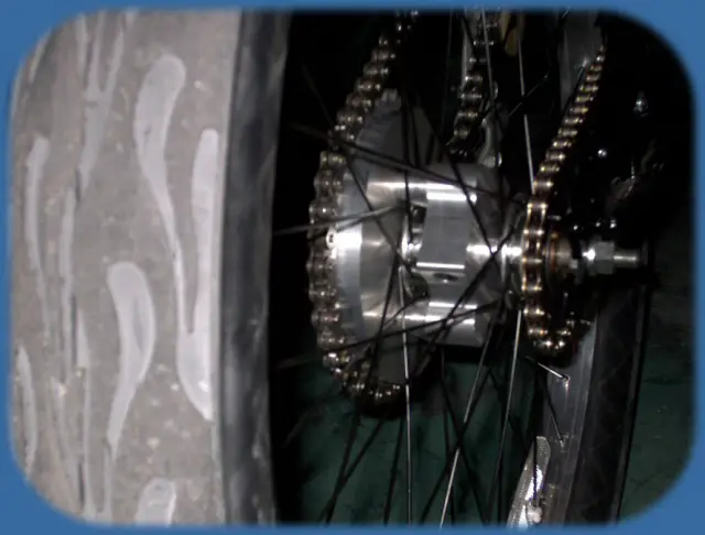

Welcome to the forum hutch - the addiction becomes severe btw
A quick tip - the only real issue with these kits and by far the most annoying is the "rag-joint" method of mounting the rear sprocket. I heartily recommend getting one of these Manic Mechanic sprocket adapters;
Manic Mechanic's SPROCKET ADAPTER
Excellent quality, solves many of the vibration/motor mount problems resulting from an out-of-center sprocket and is by far one of the simplest yet most rewarding upgrades. He tends to be back-ordered, but patience is rewarding lol
