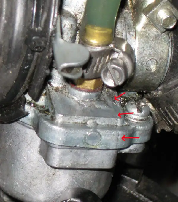

Another carb on crack... erm... crack on a carb
Found it this morning, I had thought it was fuel line/inlet leak, and yeah... it kinda pisses me off lol
This is a very good name for a thread

Naw - I agree w/you Norm, I really don't think most any repair would last. Perhaps if I lightly countersunk the fissure, fluxed and soldered... o_O
WTF am I thinkin'
The part that pissed me off wasn't the crack so much as the primary reason I had removed it in the first place was I wanted to track down that leak. I put a new bowl gasket in and one for the fuel inlet, I also rejetted it with the guts from the newer style carb as I noticed they were different.
It wasn't till I got it all back together, put it on the bike and turned the fuel on that I saw the hairline crack - just in time to leave for work.
I shoulda just swapped carbs /facepalm
So guess what this mornin's lil project is lol, but thanks for the offer man
