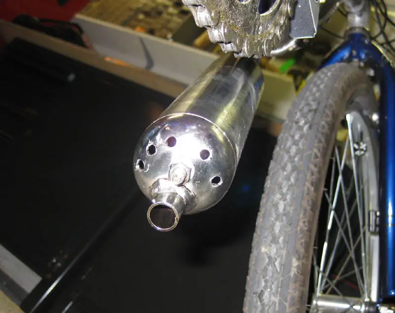

I pulled the exhaust pipe off tonight and noticed that in general the size of the pipe very closely matches the exhaust port. Not much of a performance increase could be made there so I decided to drill five holes in the end of the exhaust pipe. After the holes were drilled I slapped the pipe back on and took her for a spin. What do ya know...it definitely has more torque and acceleration!! Granted, it's a little louder now because of the holes but I think it's worth the compromise. Mission accomplished!!

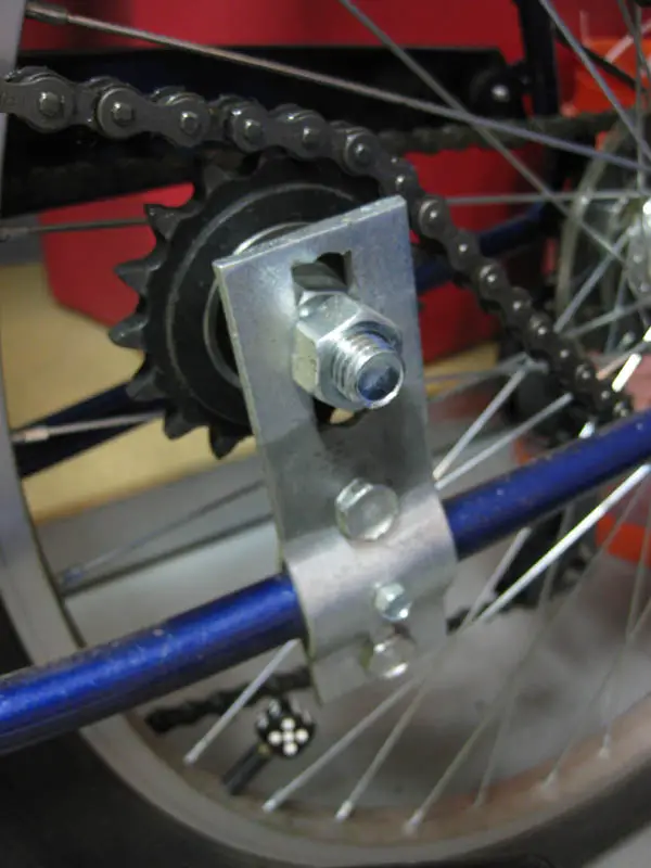

On another note. When I first assembled the bike it didn't take long to notice just how flimsy the stock chain tensioner is. The chain wasn't lining up exactly between the front and rear sprockets so that caused even more of a problem. The biggest problem was that the chain coming backwards from the front sprocket wasn't lining up very well with the rear sprocket. The misalignment was causing the chain to pop off of the rear sprocket. I finally gave up on the flimsy tensioner and went to Tractor Supply and bought a 17T #40 chain idler sprocket. I was able to use the existing tensioner mount and put a bolt through the idler sprocket. I also drilled a hole and put a small bolt through the base of the chain tensioner bracket to keep if from rotating into the spokes. After that modification I have had zero problems with the chain alignment.
Some pictures of both mods are attached.

I replaced the idler roller with a wheel from a skate board that was wide and had two bearings. It works extremely well.

cant you jsut take the baffle out and not drill holes? my friends bike doesnt have his in and it sounds awesome
Unfortunately my baffle isn't removable. It's no big deal since I plan on getting a tuned exhaust at some point.

after reading guess its better to gut the muffler and take the baffle out then drill some holes in the cap and put it back on

Different levels of low will effect the engine different ways.
Drill, gut, leave it alone, the choice is yours.

I tried this sprocket on my Grubee 66cc kit and the sprocket is too big for my 415 chain. Do I have another option?

opening the baffle too much allows too fast an airflow and will change your fuel/oil ratio too lean. it will harm your motor..... i do all of my customers with three 1/4 inch holes (after a good breakin (2 gal @ 16/1)
you will see more performance and power.

the tensioner does 2 things.....
adjusts tention to desired setting and guides the chain onto the rear sproket. you can compinsate for misalignment (minor) by guiding the chain.
too far to the rear does not allow enough time for this and too far forward and the chaid will have too much side to side slop to stay on. exactly centered is not required.
these are my findings of course. yours may vary lol....

I just searched for idler sprocket on the TSC site and it came up with various sprockets. I'm thinking of eventually just using the pirate cycles spring loaded tensioner with the optional sprocket.
I just wished the sprocket mentioned here had been narrower so it would have worked.
