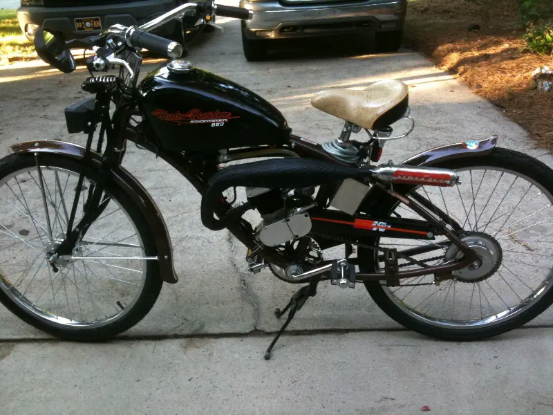

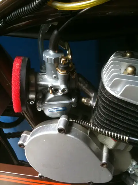

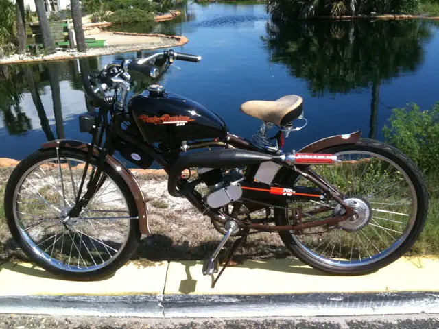

Originally Posted by The 26incher View Post
Outrunner, could we please see pic's of your bike? Thanks
I really feel like my engine spins like crazy. I would love to have a tach and speedo.
Here are some photo's of my bike, I have changed the air filter and added a "Thudbuster"seat post for a much smoother ride.

Old 01-15-2010, 03:01 PM
Cabinfever1977's Avatar
Join Date: Mar 2009
Location: Upstate,NY
Posts: 2,292
Default Re: What's the maximum RPM you"ve reached?
That really is a great looking bike. I believe your speed,i was just suprised your rpms were so high.
Old 01-15-2010, 03:16 PM
BarelyAWake's Avatar
Join Date: Jul 2009
Location: Maine
Posts: 5,625
That is a sweet lookin' ride - nice combo of elements for an overall effect, I likes it
