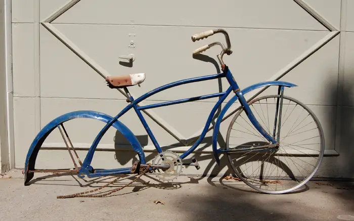

Well I did it.
I went and bought the 1951 skip tooth Columbia
that I found on craigslist.
I am going to get it going under pedal power first,
then add the engine later.
I'll keep everyone posted.
Any comments or suggestions are welcome.
Best,
BC

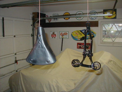

Hey,
I actually had some time this weekend to work on the bike. Managed to bob the rear fender and move the brace to a vertical position like the HD peashooters. Also cut and welded the seat post so it would lower and move the seat to the rear. Managed to get the seat frame separate from the seat pan. Primered both and painted both with rattle cans. The plan is to recover the seat myself. I'll keep you posted, thanks for looking.
BC in KC

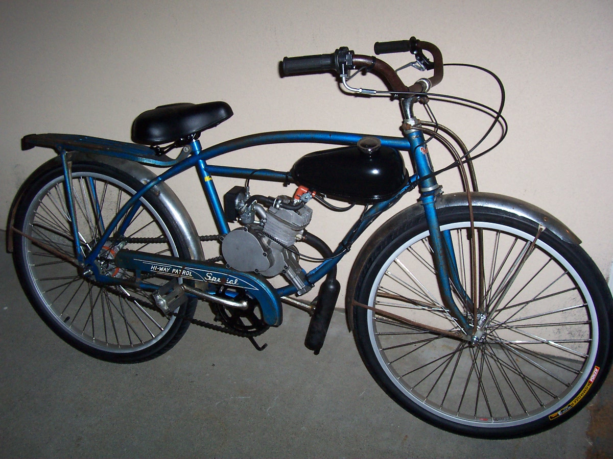

i have almost the same bike. it's a 1956 goodyear hiway patrol special, made by columbia. our frame's are the exact same.
the motor's a real tight fit. i had to use a smaller front chainring and lower the chaingaurd to get some clearance.
once the motor's in there, it fits like a glove. didn't even need the chain tensioner.
as far as the brazed joints go, i was worried about that, too, but mine's held up to tons of abuse with no problems (yet.) these are pretty strong frames. if yours is in good shape, i wouldn't worry too much about it, just keep an eye on it.
since we got the same bike, lemme know if you have any probs putting it together, i probably had the same ones, and solved them already.

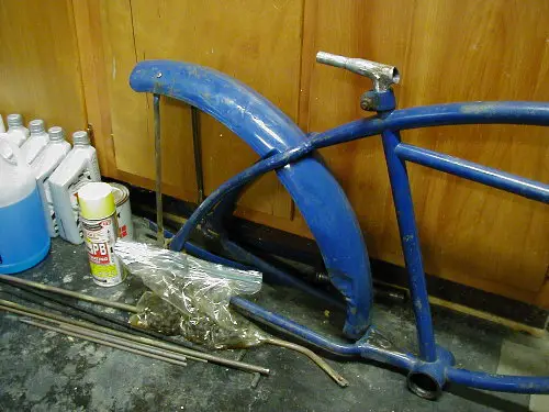

I'm attempting a 1935 build I got it on craigslist and the guy had dozens of old Pre War frames. I find that I could take off all the paint in a couple hours using a dull pocket knife
the chrome-moly steel and braized joints will be lft showing on my bike I am going to polish it and leave it. along with my frame I recieved Phantom fenders and the headliht mounted in the front fender . when stripping that I noticed tha the material was second rate compared to Pre War steel. It seems the older the better on steel and welding
