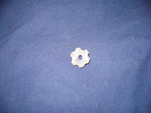

So I got the clutch cover pulled off and when it came off this dude fell out on the ground.
It's obvious that it is suppose to be threaded on to the clutch assembly but I'm not sure how it's suppose to go. Is this the flower nut? If it is, it was completely unthreaded from where it was originally attached.
Now that I have it disassembled I'm having an extremely difficult time getting the cover back on because the spring is pushing out on the round plate that has the three holes in it. Any tips for this?

After referring to this
http://motorbicycling.com/86495-post2.html
I realized that the flower nut is suppose to be on the outside of the plate. Since it just fell out I had no direct reference to the way it was suppose to go. Thank God for that awesome animated diagram.
So I got it pretty tight and the clutch now engages and disengages properly or close to it!!!
