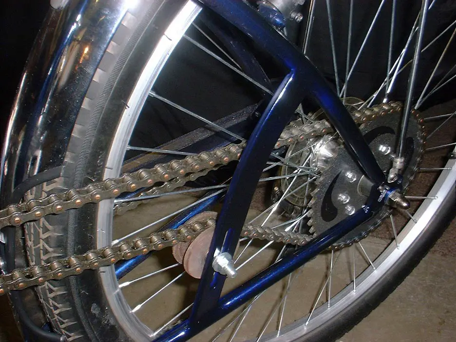

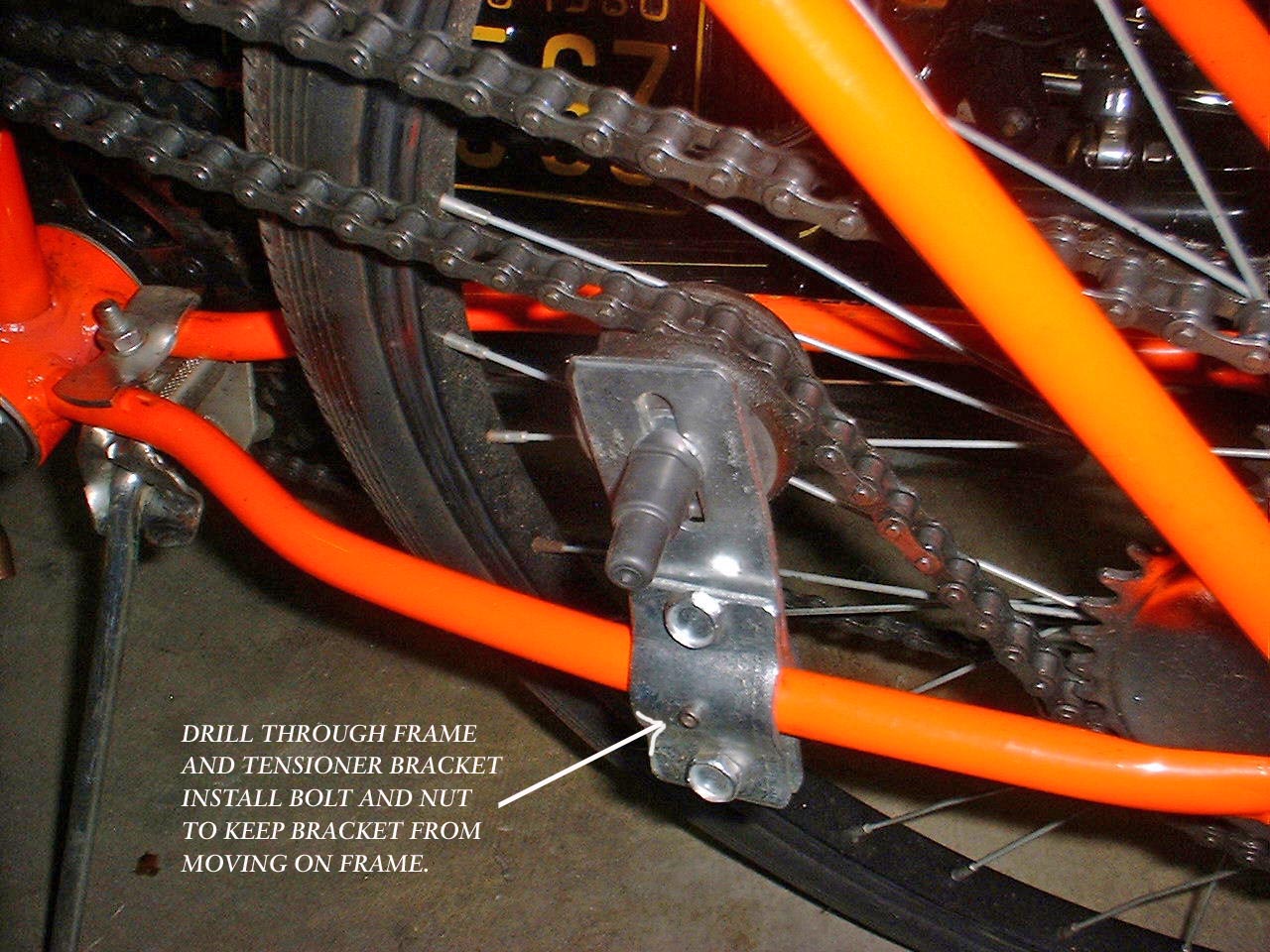

Personally I have three bikes, one has over 1500 miles on the kit chain tensioner with no problems. The tensioner needs to be secured to the chain stay so it can not rotate into the rear spokes and the bracket given a slight twist to align the wheel with the chain correctly, but there are other alternatives. Here are two views of two different approaches to the tensioner issue.

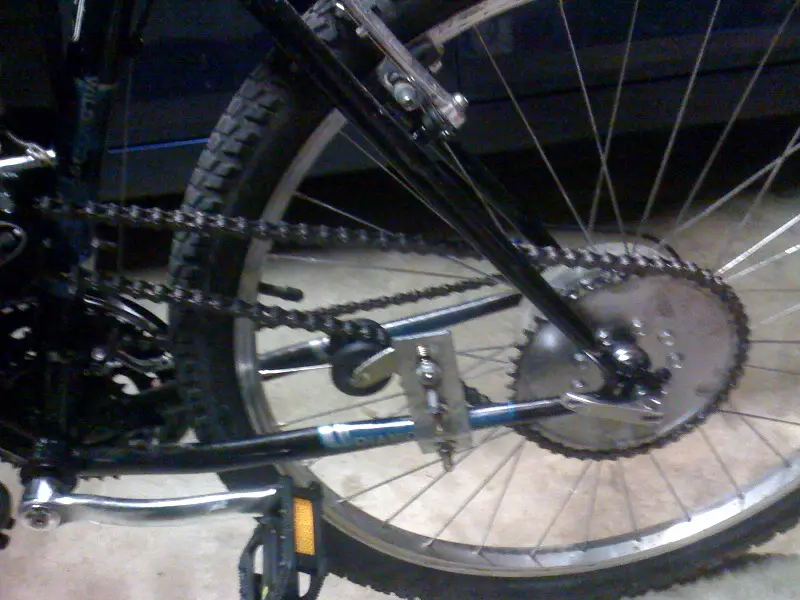

try the chain tensioner and spring from tractor supply mention in other posts, i used the cheap chinese bracket with new automotive bolts and lots of thread lock, works well now.
to keep the tensioner wheel from sliding down in the slot i added a extra bolt in the slot as a block.
also used some teflon tape where the tensioner turns on the bolt.

thats a good idea drilling a hole to keep it from turning. mine got loose a couple of times till i switched to automotive grade bolts and used thread lock where the metal clamps to the frame. i was worried about weakening the frame by welding a cross piece
Welding to the frame, if done correctly by a competent welder will not weaken, but will strengthen the frame. Underline "correctly" here. A bad weld can be a weak area and if the base metal, the frame, is not incorporated into the weld it can fail at that point.

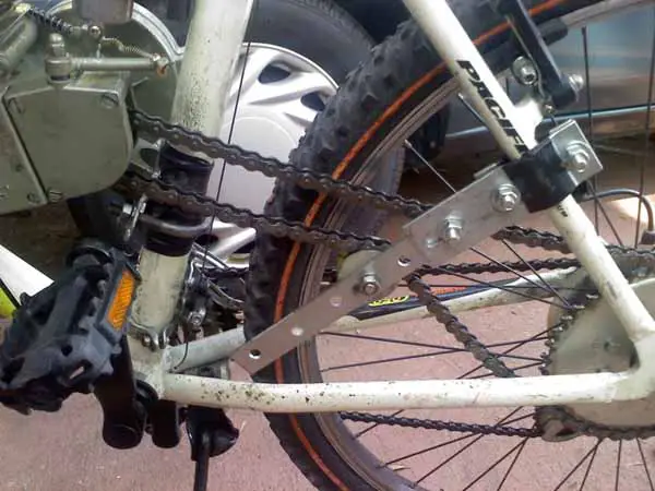

i realize that this won't work for all bikes, and if i ever need a chain tensioner, i'll probably try to modify something like this:
Name:	chain tensioner.jpg
