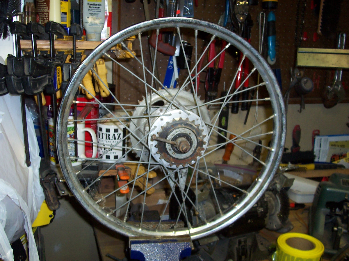

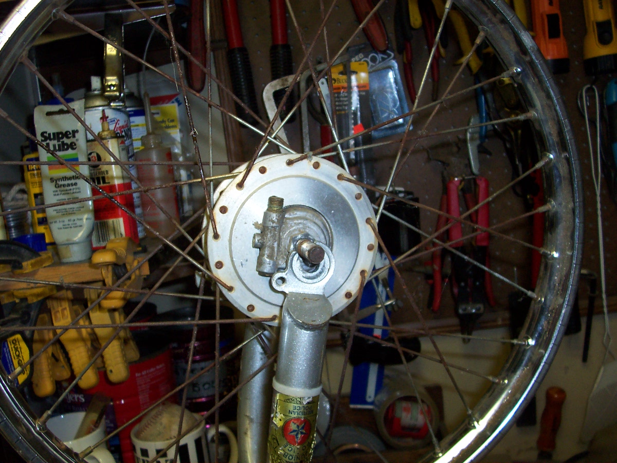

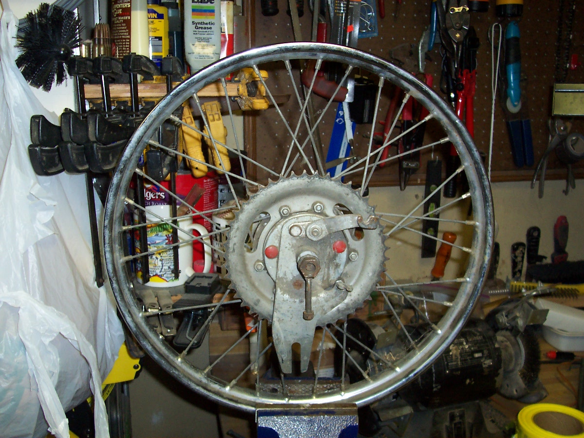

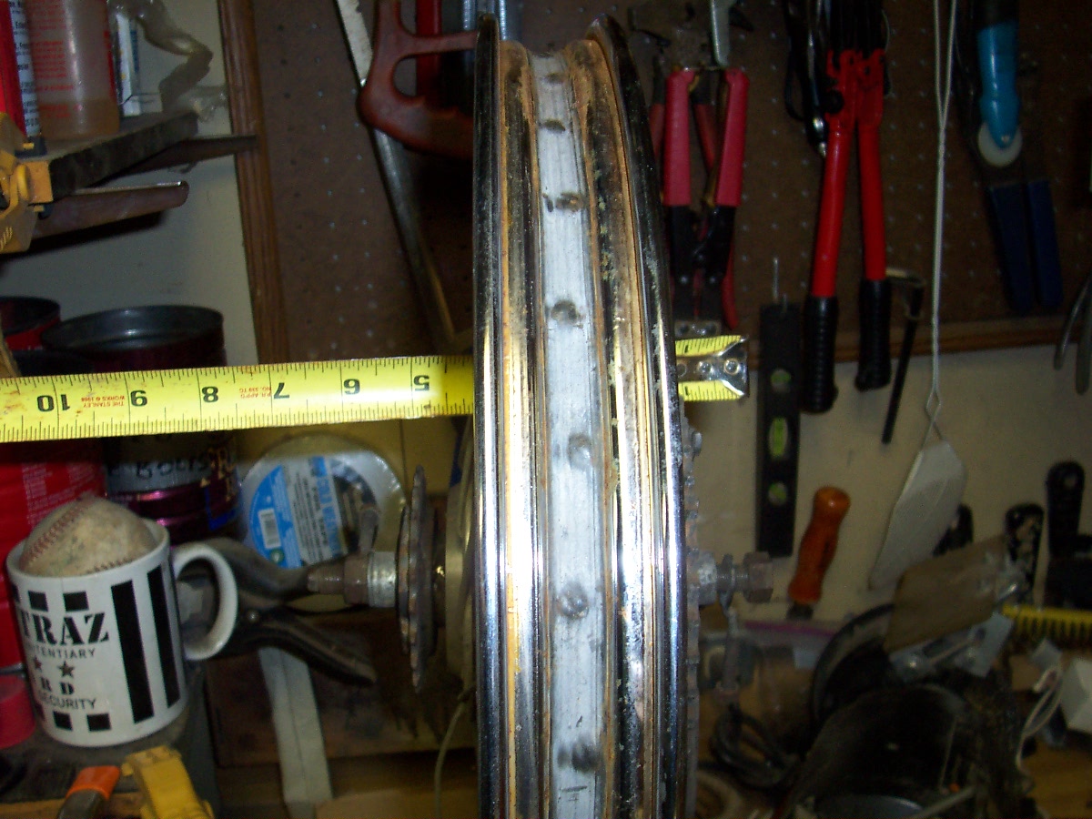

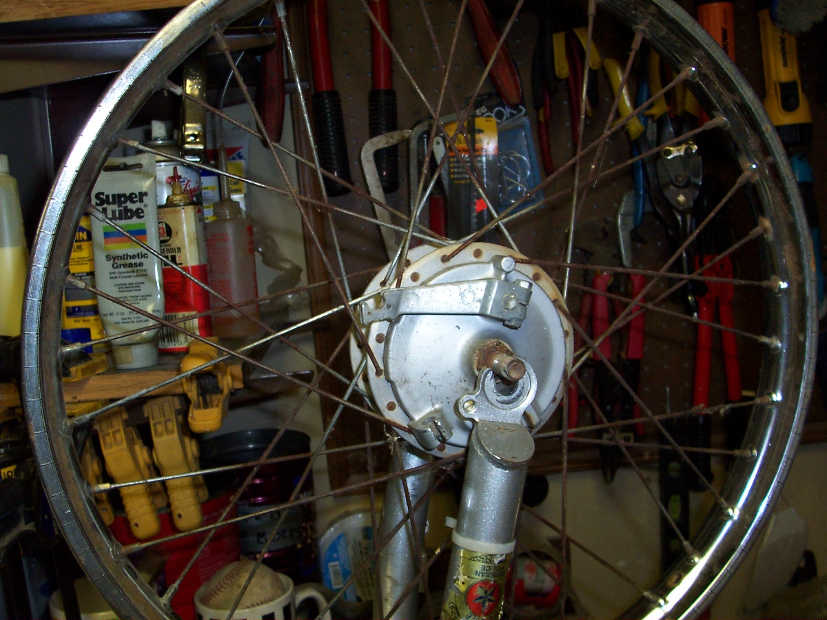

Well luckily they're both 36 spoke and the front will fit right onto the forks with a little bit of grinding on the axle slots. The rear is a wide one, hard to take a picture and hold the tape at the same time but it's a little over 5 1/2" so some modification of the rear will be necessary. The freewheel sprocket has a busted tooth but that's ok because I really didn't want a 22T rear sprocket anyway and if I wanted a straight 44T drive sprocket I'd be all set but these will be going on my board track winter project so I guess I'll have to have a custom 36 tooth machined.
