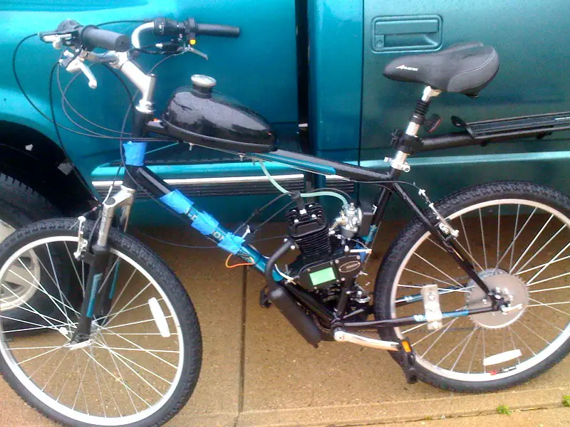

i used masking tape to hold the wires and cables during the build so i didn't waste zip ties and made easier to change things around.

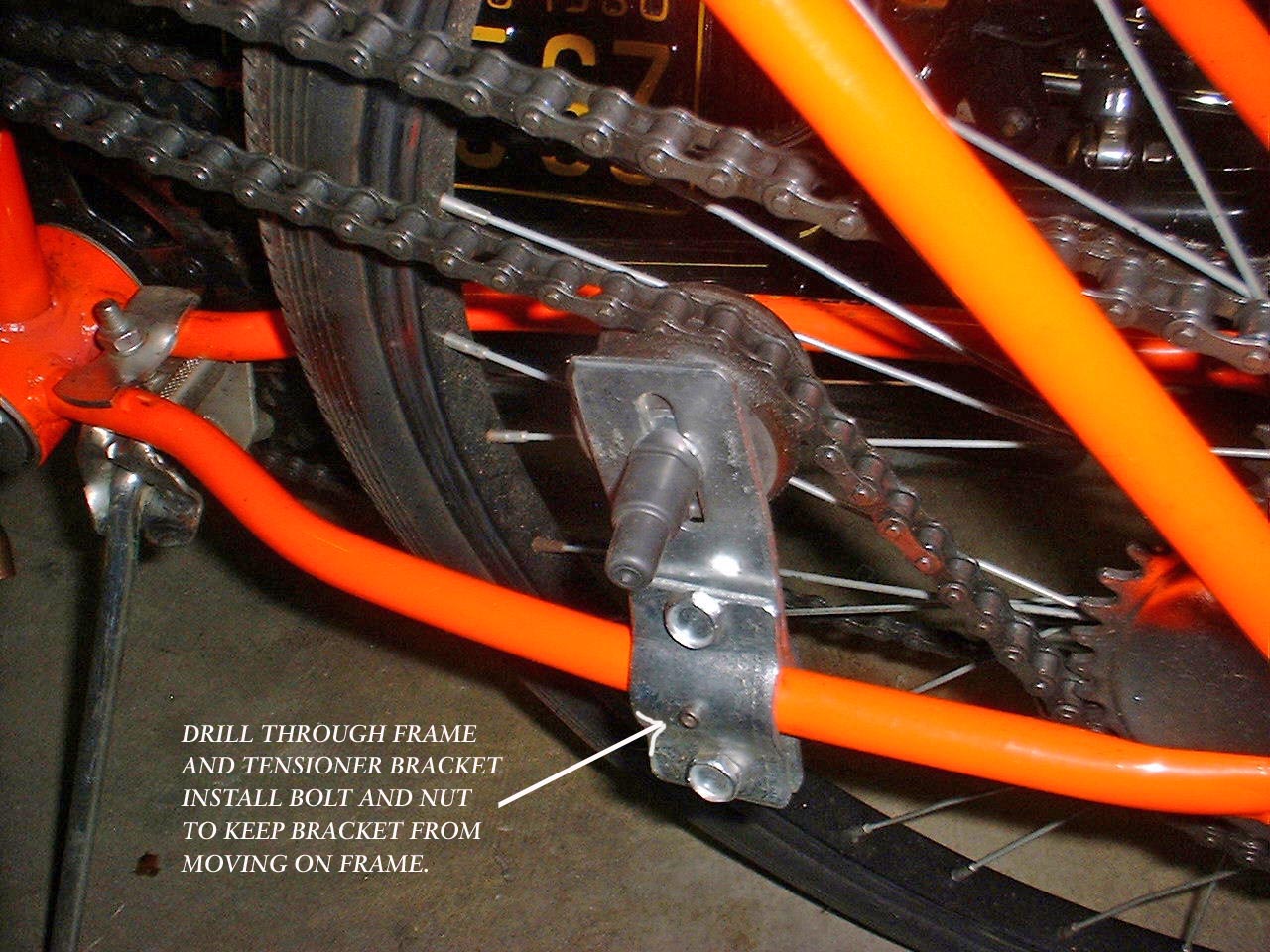

Here's a sure fire way to keep your chain tensioner from destroying your rear wheel. We have posted this time and time again but guys still continue to install the tensioner with no provisions to keep it from rotating into the spokes. Sorry you had to learn the hard and expensive way.

If you have access to a welder here's an idea. There have been several brackets made that have been clamped instead of welded too. Whatever works for you.
