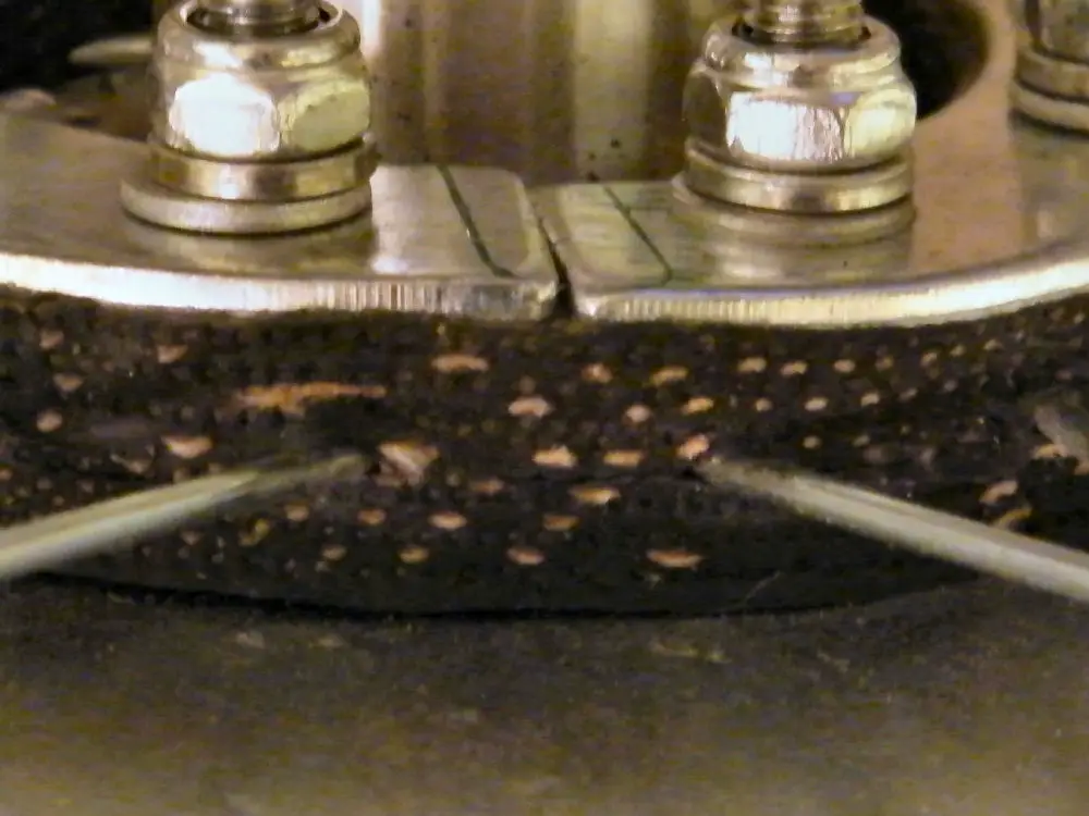

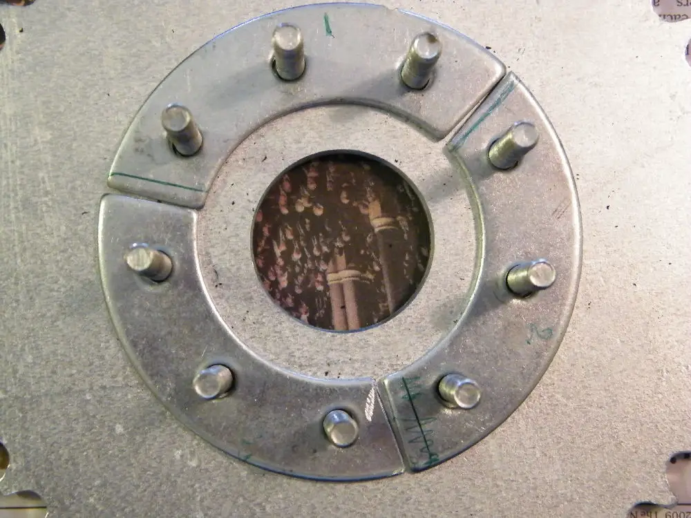

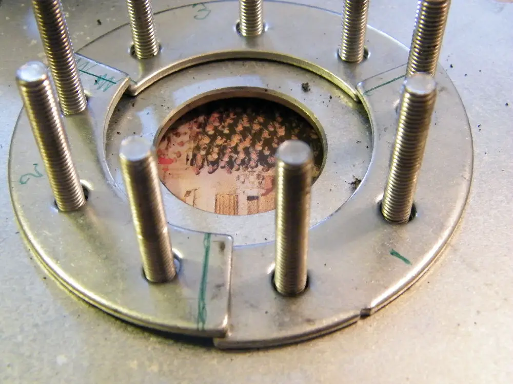

The backing plates for the rag joint all over lapped by 1/8 to 1/4 inch each. I cut 2 of the joints and the 3rd joint fell into place. That is until it was assembly time. that 3rd joint overlapped again so I just followed the advice given by the seller and preyed the apart till it lay flat and went about tighten down the nuts. Well there was quite a high spot on the sprocket and as it turned out it was right over that 3rd joint.
As it turns out the whole thing has to come apart any way because there is a clearance issue with chain and tire ( flat sprocket ) so I was thinking of putting an extra piece of rubber between the out side rag joint and the sprocket. Also think I will order a Manic Mechanic sprocket adaptor latter this week.
Couple of pics to help explain.

Dude scrap it and start again either with creative's hub adapter or start again with a new rag joint do not cut it! if they overlap pry it with a screwdriver. Also there is no need for the metal 3 peice on the other side of the sprocket as the sprocket does this job. I did the same but found that the 2 piece and the 3 peice go over each other inside the hub then the rubber pieces then the sprocket.

Out of 30 or so sprocket upgrades I had six with that issue. They happened to be the ones that came with BGF $12 36t sprockets so maybe no surprise.
It only takes a minute to get plates seated by levering them apart with screwdriver. Once flat tighten nuts equally so edges don' t pop up. Not a problem for me at all. I had much more difficulty with clamshell mounts and coaster brake installs. I also believe the rag joint type absorb shock and extend spoke life more.
The first one took a few minutes longer but the rest went quickly now that I know.

It was part of the 66CC kit I ordered. I'll refrain from stating where the kit came from. Don't want to start a bash fest, just curious how often this might come up. If I reuse the rag joint that 3rd joint will get trimmed. Honestly I just don't see how the backing pieces would have laid flat with that much over lap on each segment (1st picture in original post). Had I just trimmed that 3rd segment it would have probably turned out fine. Those little bolts got cranked down ALOT to smooth out the high spot with in ~1mm. Half stepping it again that’s all. It will be a little while before the engine gets fired, after looking in the exhaust port there is a little flash that should probably be removed. Working on 2 stroke motors is all new to me. Time to start reading up. Winter is right around the corner and I HATE the cold and snow so there is plenty of time.
