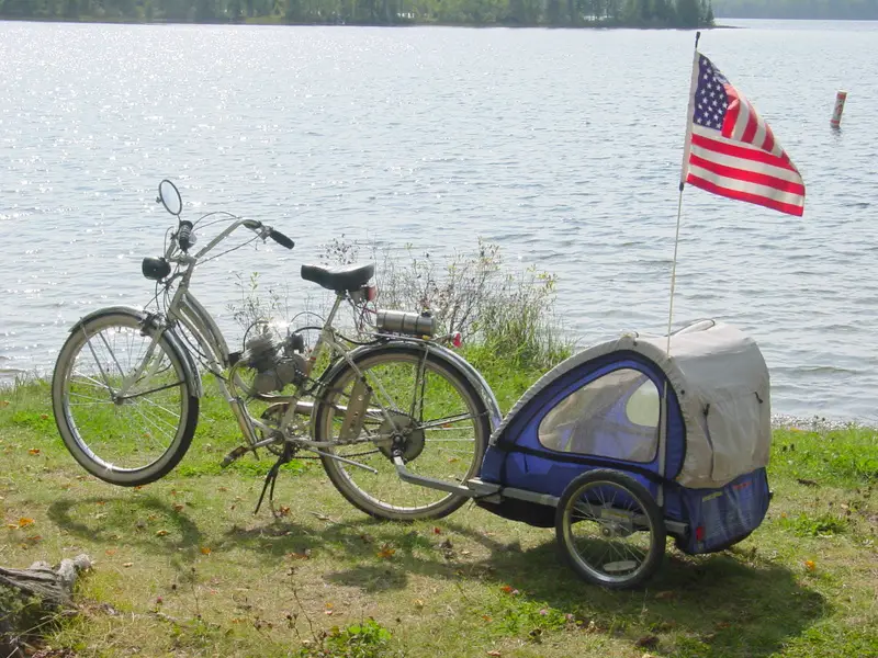

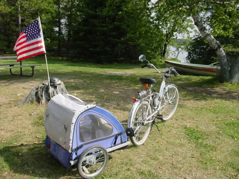

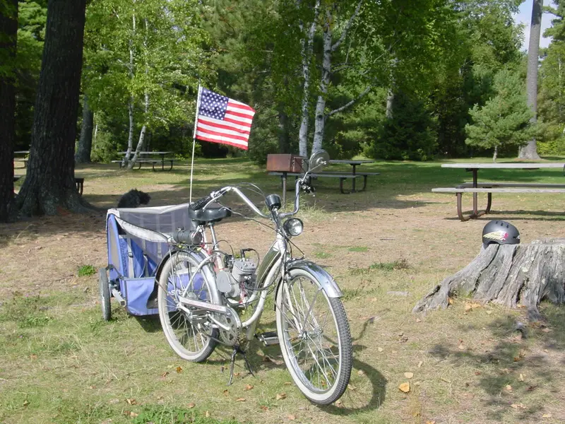

I have the good fortune to live in the Superior National Forest of Northeastern Minnesota, a state with over 12,500 lakes, most of which are in the northeastern portion, known as "the arrowhead". Nearby is the Vermilion Reservation of Ojibwa Indians. I am a mixed blood myself, but not Ojibwa. Pictured here is the other 63 American Deluxe. I like the white with all the chrome. I'll share a secret... as originally made and sold, the bike had pink trim on the chrome tank, chain guard and seat. Ditch the seat for a wide Worksman and remove the pink from the tank and chain guard (I did leave the Schwinn Deluxe lettering) and it instantly changes the bike from girlyman to "step through". Now it is officially a step through cruiser, remember that as my manhood is at stake. To my eye the bikes look more different from each other than they should for the few actual differences. The headlight is out front and lower and the gas tank is from an Iron Horse lawn mower. I tried it crosswise and lengthwise and am still thinking about which way it should go. I think maybe the way it is. The rear carrier is actually a front rack. I put it in a vise to change the connecting portion bend, put a small hose clamp on the seat post at the height I want the seat, slid a large washer of the right size on to the post which is held in place by the hose clamp. Now I slide the connector for the rack which originally fit onto the front fork goose neck. Now another hose clamp on top so the rack can't travel up or down, but is held firmly in place. Then the seat. It works fine, looks good and is very secure. i hope some of you like these old American step throughs. I get lots of compliments and many questions. Now that I am embarking on building bikes for sale, these Americans are going to get new paint, the new fender lights and new chrome fenders. I have some classy Indian gas tank decals.. (nos and not vinyl stickers) for the final dressing up. They will be the advertising bikes which I will ride around wherever the rich folks are. No, they don't pretend to be any motorbicycle that Indian ever made, but one they might have and is in the spirit of. They are Americans and the rider/builder is Indian, so that's good enough for me to eventually refer to them as American Indians. Yeah. They are going to be my signature motorbicycle, aimed at the geezer crowd. Pull start, centrifugal clutch, fat tires, step through and easy to ride. I hope it's a winner.

Silver B,
That is a lovely ride, sir. I had to giggle a little at the first pic, the one by the lake. Your engine seemes to have just a little vibration issue there...
All kidding aside, your beautiful step-through makes me want to try to convince my wife to let me put a motor on that classic Huffy she found in her dad's shed. It's hanging in my garage right now and just begging for something to be done with. I'll keep you posted.

Thanks for the nice comments everyone.
Tom, I had to look twice at that picture of the white bike, too. In the photo it looks like the motor is vibrating like crazy and it wasn't running! The rest of the photo is clear enough. What's with that, I wonder. Glad you like the bike. I'm not really done on either one and the white bike needs to have the ignition module moved to the seat post as it is on the blue one. Along with the slant head facing backwards it gives quite a lot of room for your leg to pass through. It works for me and I still like looking at them. These Americans have a low dip in the upper bar which allows a low engine mount. Some step through bikes are pretty high up.
