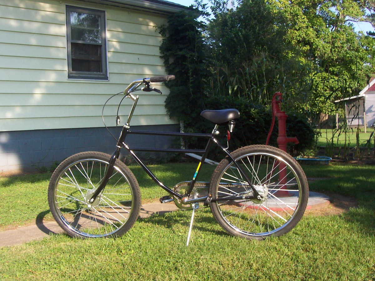

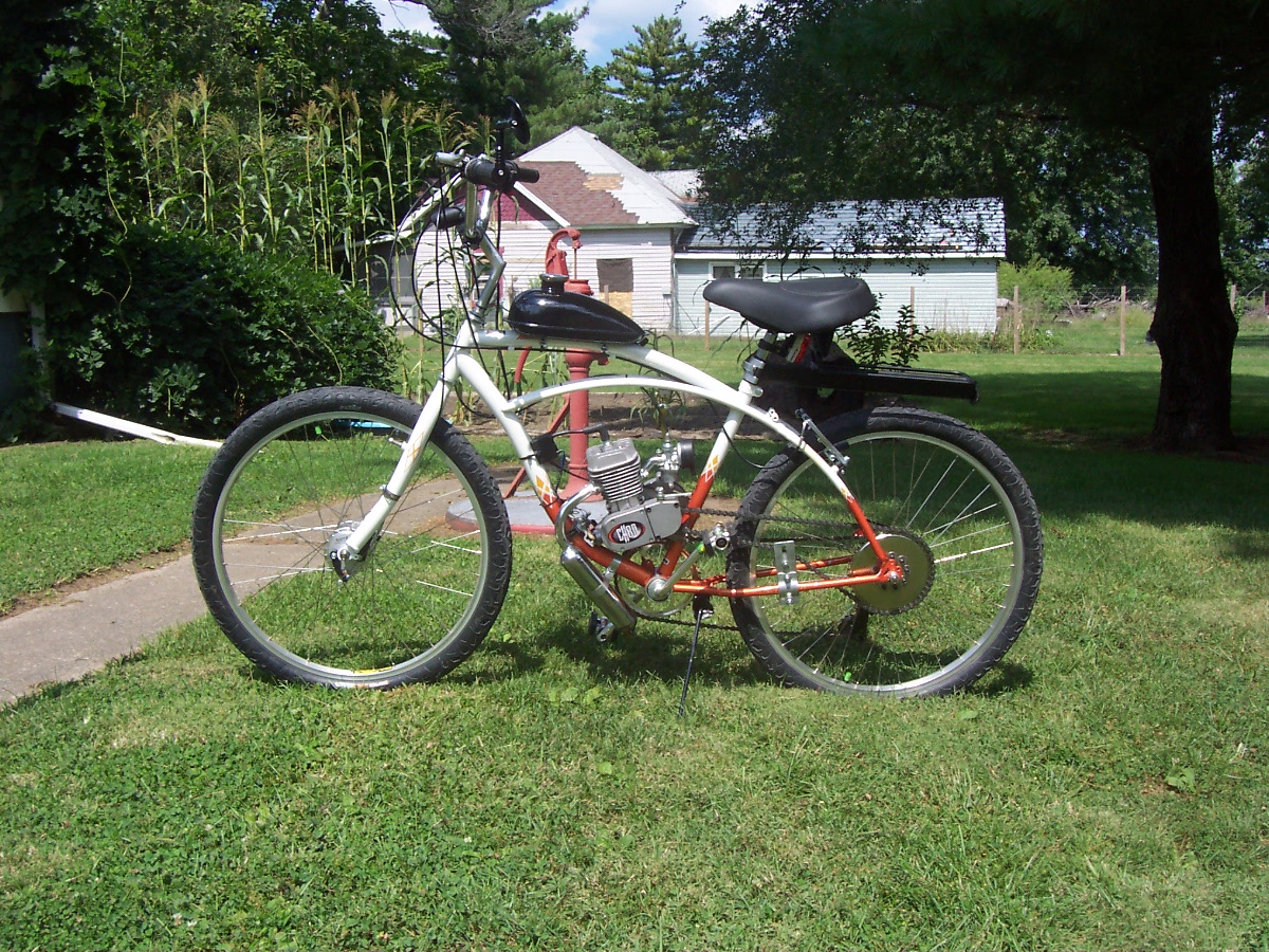

I recieved this in March of this year. This was going to
be my first build but since I had no expierance with the
2-stroke HT engine, I thought it would be best to try
an easier build first- Schwinn LandMark

Thanks for posting the photos. Very nice. That was good thinking taking on an easier build as the first one. Now that you have some experience under your belt, what do you have in mind for the Worksman? And what is your impression of it? Ride nice? Drum brakes front and rear must be awesome. That's going to make a heck of a mb...

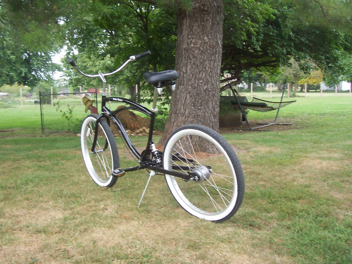

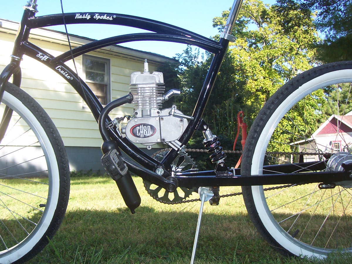

The worksman bicycle that I have is refered to as an Urban Assult
bicycle or more popular Maui Downhiller. On the paperwork it says not
responsible for heart attacks. On level ground i the single speed becomes
a chore to peddle. If you find a small rounded ridge coming off the payment
; it is a breeze to peddle.
I am not sure about the worksman project yet. I am on my second build
a soft cruise beach cruiser that looks like it has rear suspension but it is not.
It is just like some seat post suspension but only fancier...lol. I am lucky on this
build because I get to learn about wheels and rims.....so the karma must be with
me because I will need this build experiance to figure out about the worksman
project.
The build in progress has a 5 1/2 inch spread frame that lines up with the chain.
The front and rear tires do not line up and are off 1 1/2 inches. So I will try to
correct it with a back rim that has a frame spread of 4 inches. The Worksman
bicycle has a frame spread of about 5 inches with the rear drum brake rim. So
if I use a 5 1/2 inch internal gear rim on the Worksman , I believe the rear tire
will be 1/2 inch off from the front tire. I can not have that on a motorized bicycle
that I will value my life with. Only the experiance I get from this build will lead
me to a worksman build with a shift kit.

That's a nice looking build you have there. I like it, but I am partial to the old cruiser look. I really like the dark blue. I had been thinking to paint one of my Americans and the Worksman a cobalt blue. I could dive off into that color and go swimming... ha!
I'm thinking my Worksman is going to be a serious ride, with a rear wheel clamshell adapter and a shift kit. The shifter may have to wait if funds are tight, which is the usual case, but that is something I can do later. I hope we can compare notes as we mount engines on our "Worksmen" and install shift kits which will be new to me. They should make great cruisers. My rear wheel will just be a coaster brake which may actually make things simpler as I read your description of possible alignment problems between front and rear wheel on your Worksman. The bike I'm getting does not have a drum brake front or rear so I intend to replace the front wheel with a heavy duty Huffy with drum brake. I have no intentions of setting a China Girl land speed record, so drum in front and coaster in back should be ample for the way I ride.

I got to prove my thinking on rear rim set-ups was wrong. On the soft ride
beach cruiser the Shimano 8-speed internal gear drive with coasterbrakes
wheel with 5 1/2 inch axle spread that gave the appearance of being way off
from alignment with the front wheel was simply corrected by putting enough
washers behind the coaster brake arm, that put it in alighment with front tire.
I am relieved that this was all it was causing the problem. This is my first learning
expierance with internal gear drive rims......I am so reliefed
