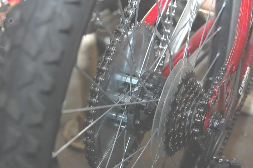

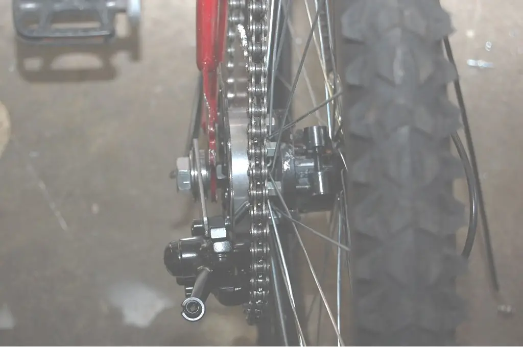

here is my version of a sprocket adapter and am adding disc brake to it (tired of panic stops). after completion am going to try to run both calipur and disc brakes on same wheel. My clamping mechanism leaves something to be desired. So if i get any movement at all will put rag joint back in to stiffen it up. have a nice day. bob

mk didn't use wide axle just machined spacer to fit what i had then hung calipur on outside. just took a cut off bolt and machined it down to fit bearing. then drilled and tapped it to axle threads. in my case 10mmx1.0 (it varies). that way brake should run true even if you have to adjust wheel. Still have to make setup so brake is self centered(a work in progress). Good luck on your endeavors. bob

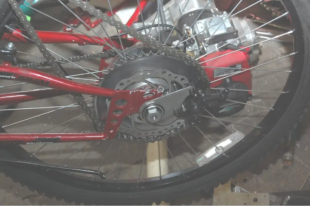

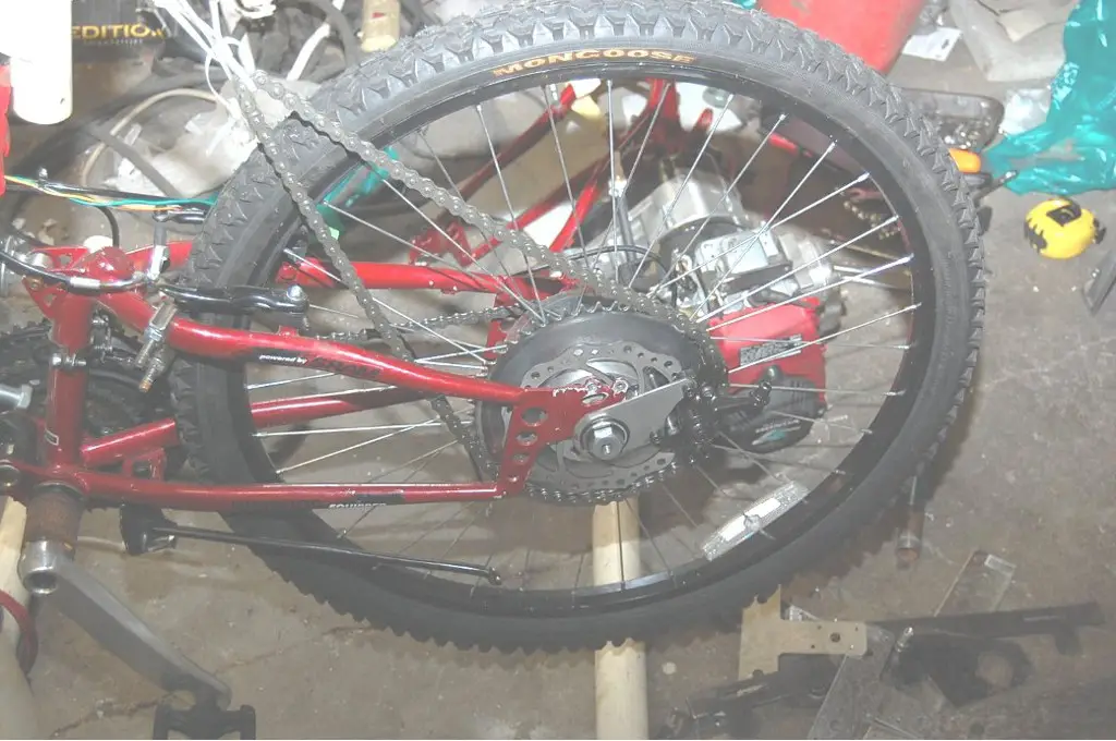

This is what I did. I just had to grind a little off the caliper mount and use a smaller spacer between the spokes and the sprocket. Works a treat.
