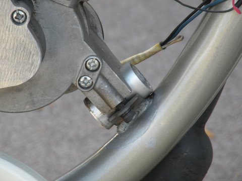

heres how i attached the engine mount to the frame. it seems to work just fine. notice only the clamp is welded to the frame so it's still readily removeable-seems to work fine and didn't take but a minute. i don't know if all cranbrook frames are the same but these 2 were.
