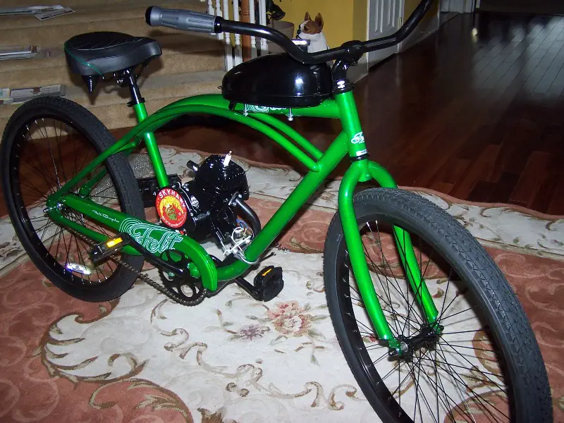

Do I need to change my fork for this wheel drum brake kit from huffy? I am hoping that a regular fork will work with it..

nope...I used a drum on the stock jag forks and, am still using it on my springer
it's simple bolt on !!!

You will probably have to find (or make) a oversize strap to attach the drum arm to the Felt fork leg.

Yeah Venice,
I am having a problem with the brake arm strap. The one that comes with the kit is very small/ I need at least an inch and a half front brake strap.
Anyone in the forum had a fix for this front brake arm strap problem...

Hello,
What is the fork diameter of your Jag..I think it should be the same with Felt. Mine did not bolt on as the brake arm strap the comes with it is too small..

I have used the wheel on 3 different bikes and 4 different forks
when it was mounted on the haro mtn bike with fat forks, I used a piece of thick hose to fill the space between fork and arm and hose clamped it
I used a good clamp for high pressure hose, not a cheapie from ace
Bill

Actually a SS hose clamp would probably work pretty well.

Just make a strap from a piece of thin flat steel from the LHS...
