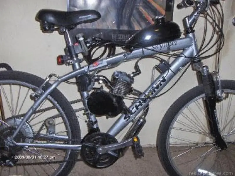

I used a non-synth Pennzoil .....initial break-in of a gallon..( two tank fulls )...at a ratio of 16:1
after that backed off with the same oil at 32:1.....the first batch did indeed smoke a tad....not that much though....ran rough for a bit......but I tell ya....it's broken in now and simply * The Scream*
Laters,
Salty
