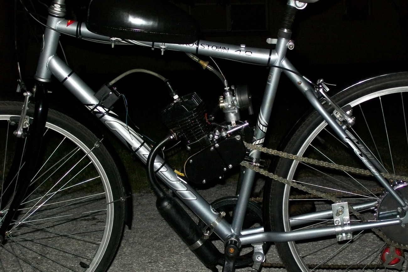

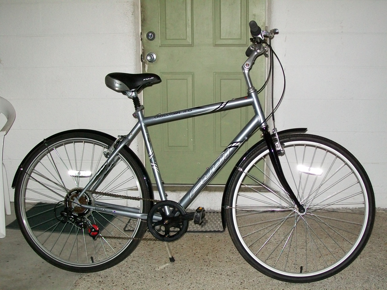

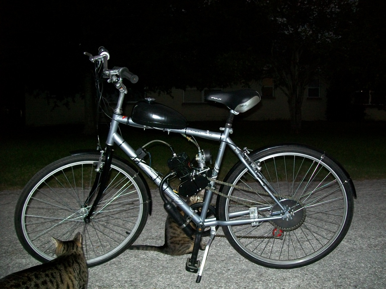

The first two pix are, here is how it looks now, bran new, never ridden, stage 1, and waiting for parts. The next two, the cats like to check everything out!! Bikes, turtles, whatever... And the last pic is my virgin untouched bike. I hope the Fuji holds up??

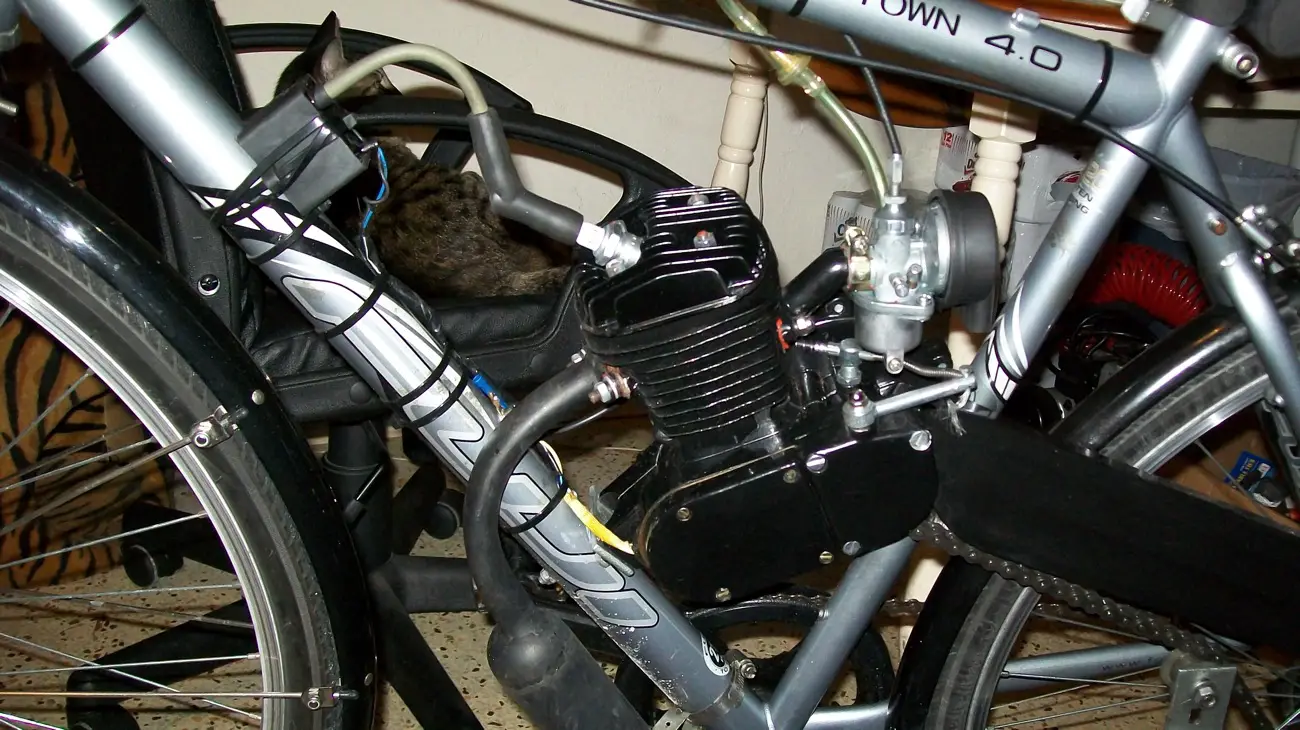

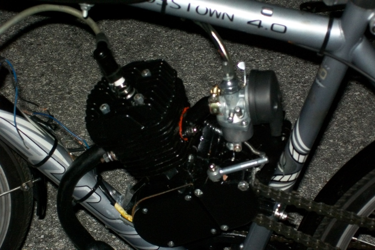

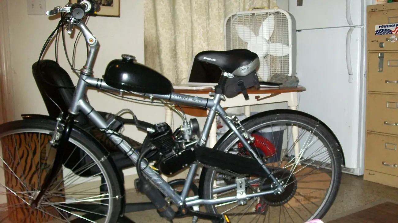

I'm back with good news and more good news. The starting problem turned out to be a faulty magneto. It started right up and after some initial tweaking, it runs great, I'm happy say. I then installed my slant head. It gave it significant power. I did have a slight problem with piston slap, that I solved with a combo of using gasket material from the auto parts store sandwiched in between aluminium roofing flashing. I may have used to much gasket material, reducing my compression more than I should have. I may reduce the thickness at a later date, however, over all, it still has more power. Check out the pix. I have an exhaust system I will install when I have a larger block of time, but tonight, good news, bad news, I need to fix a flat on the rear tire, and I will take this time to install the 36 tooth sproket seen in the pic. A report will follow.
