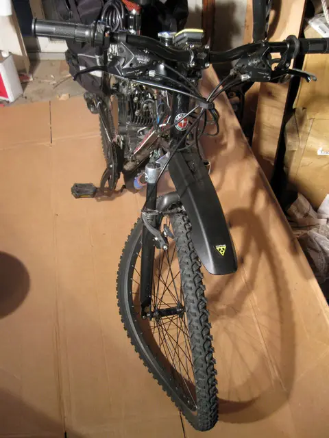

I looked up and sure enough my worst fears were realized, I could just see him in the distance - dragging my wonderful toy by it's front wheel. For just a moment I hated him a bit, then I walked out to meet him, to see if he was ok and to see how bad my bike had suffered.
As I walked, I thought about all the things I might have done wrong, what might have failed and caused my friend to crash. I worried about the rear rim as it did need truing, I thought about the engine and exhaust mounts, I fretted about the frame's integrity, I suspected he may have gotten hit by a car.
None of the above, he had simply lost it taking a turn way too fast.

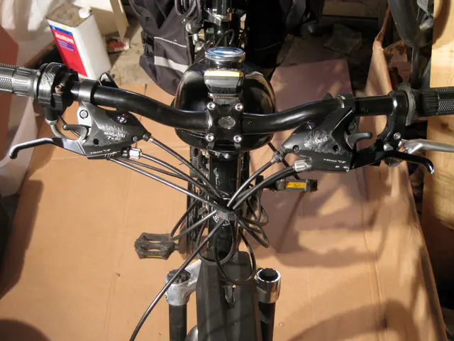

He was fine, a little worse for wear with a touch of road rash on one elbow and a bruise on his leg. My bike however wasn't quite as lucky. The front rim trashed, the pedals and crank bent and loose, front brakes wasted, the forks just a touch tweaked, both shifters gouged to heck and bent, and various other scratches and dings. Judging from the damage and his tale of woe - the front had gone out from under him (most likely sand while turning and braking aggressively) and the bike had cartwheeled.

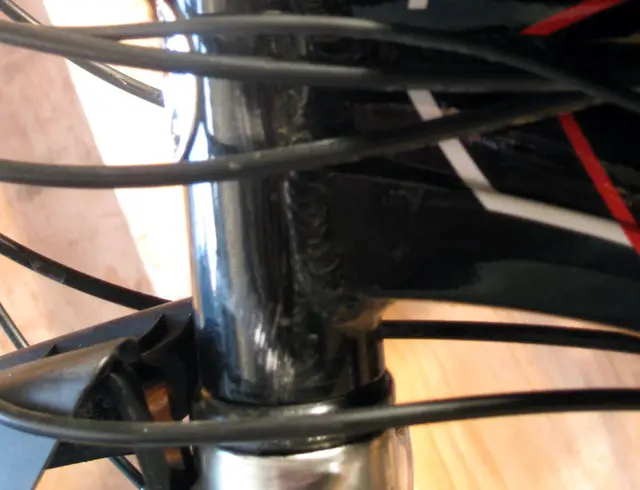

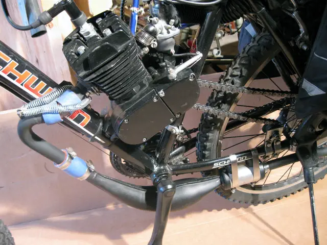

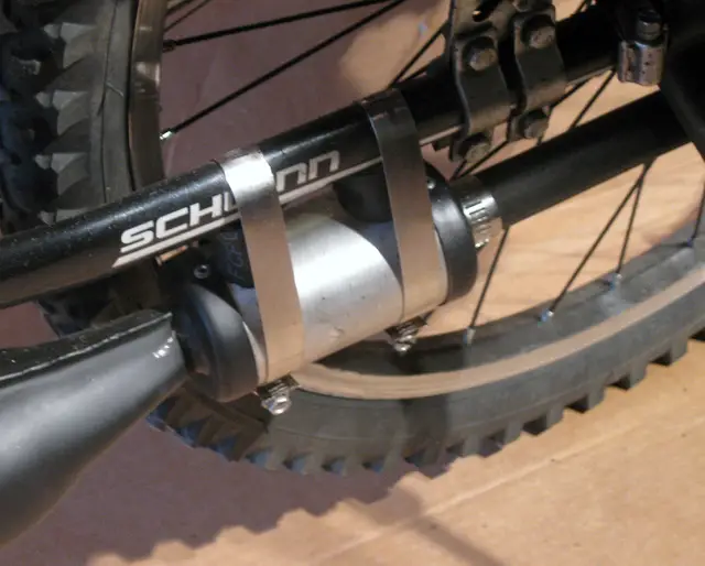

An upshot, the "silver lining" so to speak is this was a chance to see how well my McGuyverisms had stood up to this test-to-destruction. I had been forced to do the "bolt through the Dtube" method in spite of my integrity concerns, I had cobbled together an exhaust mount for my SBP expansion chamber using just hose clamps and rubber tubing, and of course there was about a million cable ties all over the place.
Not a single thing I had built or added to the bike had failed or was even damaged in any way, even my hose clamps and tubing mounts for my exhaust hadn't budged a fraction - even though the bike had obviously gone end over end. THAT knowledge alone is almost worth it.

So, here are some pics for those morbidly interested in forensics like I am and another pic of my... interesting method of mounting SBP's expansion exhaust. As many here have a similar setup - I figured you might be interested in a low cost mount technique that apparently can withstand being cartwheeled at about 30mph

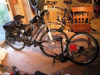

Just got back from the dreaded, evil WallyWorld with the donor bike and now that I have the parts I'm feelin' better, o'course I still hafta fix the bdang thing. One of the few charms about these cheaper new bikes is should you need parts - just get another and gut it.
If chosen carefully and ignoring the cheapest ones these bikes can be of quite acceptable quality really, I've been continuously surprised at how well it's put up with my abuses. This latest event really showed how well the frame is made despite being alloy, drilled, and a twenty pound vibrating hammer bolted to it. o_O
I tell ya what though, the new bike looks freakin' odd without a motor in it... mebbe that's jus me
