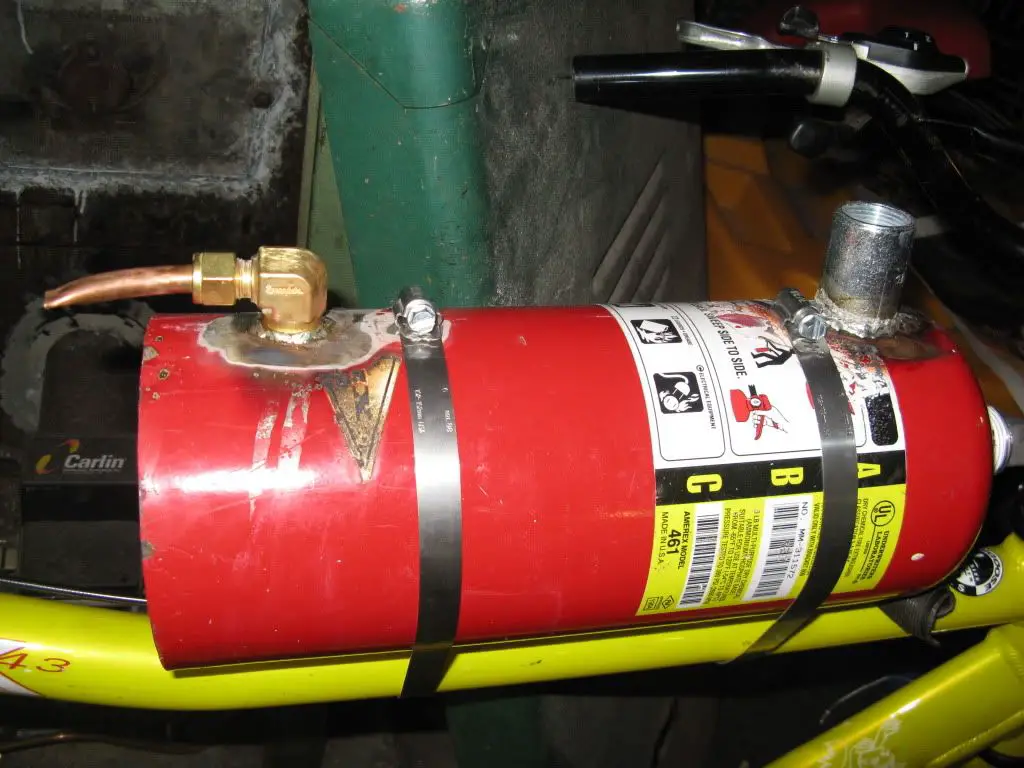

Oooohhh, decision crisis. I just got my hands on an empty, 1 gallon fire extinguisher. I think this just might be my first tank.

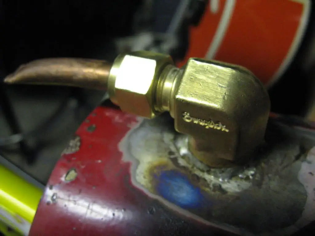

Well,
I have decided for now to use the Extinguisher tank. I still don't have enough stainless to do what I want.
The Ext. tank is working out great. I added a filler pipe and a copper air tube.
I still have to install the fuel line.
Since I do not have an engine yet, I don't know what size fitting to use. Is it a 1/4" line? or is it some metric tubing size?
I will post some photos soon (After I clean up my ugly brazing job).

Old 10-08-2009, 07:10 AM
BarelyAWake's Avatar
BarelyAWake BarelyAWake is online now
Join Date: Jul 2009
Location: Maine
Posts: 5,318
Default Re: Stainless, Problems?
it's a 1/4" line or dang well close 'nuff ayup
