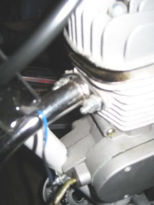

Hey there, so I just finished building my bike and rode it around a few times. One thing is that it seems to only work at high rpms, otherwise when I move the clutch for it to idle lower, it usually dies. Then I noticed some oil coming out of the front of the engine. Is that bad?

sounds like a leaky crankcase

looks like a not-tight-enough head
the pic shows leaking from head gasket
take a ratchet and hold it by the head (not the handle), tighten it down
by holding the head of the ratchet, you will have less chance of over-torquing and stripping threads
hope that helped a little
I think I got that tip from bikeguyjoe, many moons ago before this form was around

yea..its the head gasket...torque 10 to 12 lbs...no more...and you better reroute your power wires...not over the exhaust...burn everything up...good luck...Dennis

ok awesome, I'll tighten em up a bit then. thanks!

I had the same problem. Turned out to be leaking from the spark plug thread. With the engine running you could see it bubbling out. A new quality spark plug fixed it.
