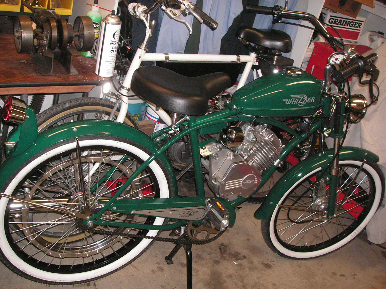

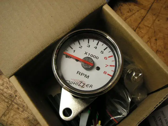

This is a pic of the bike, it cam with a Tac also I need to install. Have fun, Dave

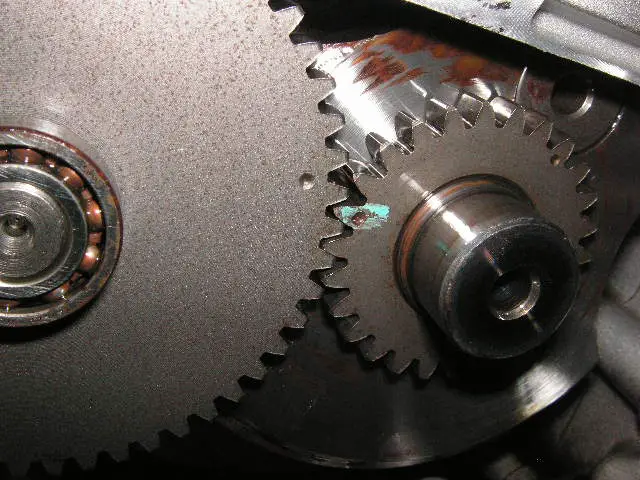

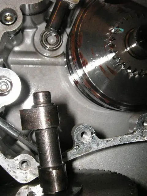

I looked at the clutch mounting today and noticed that if I reach in from the right side and grab the top of the pulleys I can wiggle then, like the hole is too large for the bolt, YES it is elongated from the factory. I guess with belts it doesn't matter there is not much alignment. The forty's way doesn't seem to fit in a modern time warp. I took the cover off to move the cam and found it moved! the bike has never been fooled with, Oh Well. The carb is a pain it is so fat the thing just blubbers, I took the air filter off to see if it would be better no luck, the main jet is too large, the cut on the front is too small and the needle is too high. I want an old tillotson. A pic of the way I found the timing. Have fun, Dave

HI, well some of the cams were set correctly at the factory, mostly more recently, but the early ones were almost always retarded ( marks on center).

I moved the ignition timing today WoW what a difference. After I got it started the idle was too high, the engine was not laboring any more. I even had to adj the idle mixture again, then I took it for a ride, well it was like a completely different bike, it is still too fat but when I cut the throttle back to a place it does not blubber it really takes off. I want to see what the head looks like and see what I can do there. I have built some old flathead Fords and we used to relieve them and get a few extra HP's. Ill keep you posted. Have fun, Dave
