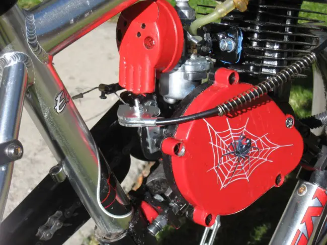

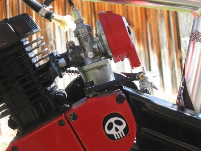

good for you...i'm going to send a couple of pics...keep them on hand...yes the engine shouldnt die...but if there is air leaks the rpms will slow down when you spray those areas...if its sealed nothing will happen...take your time and do it right...its worth it...Dennis...also ThatsDax has the o ring for the carbs intake...
