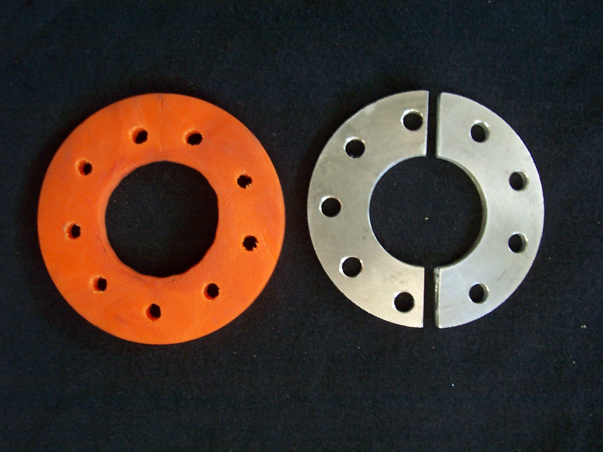

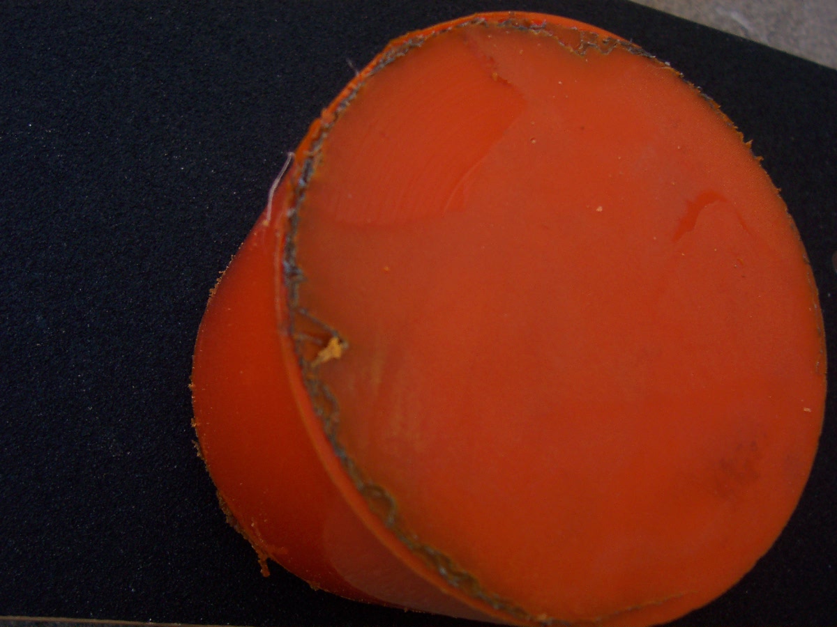

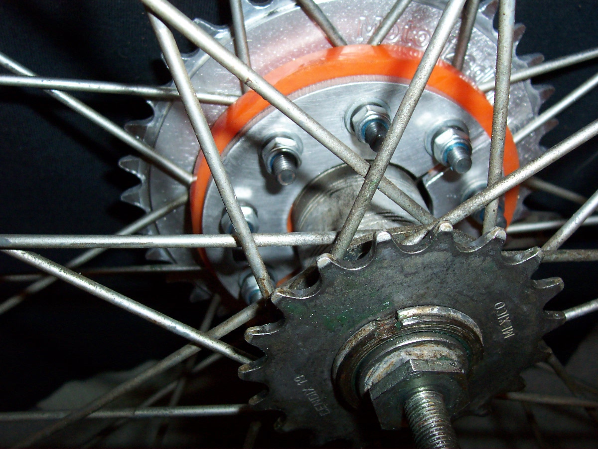

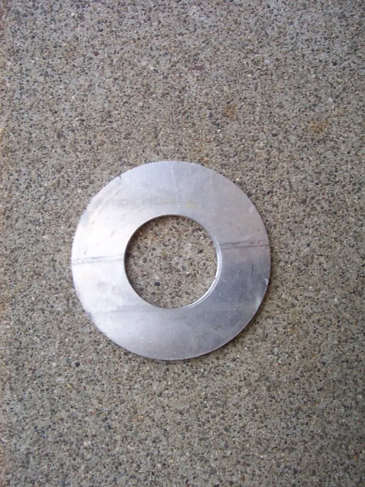

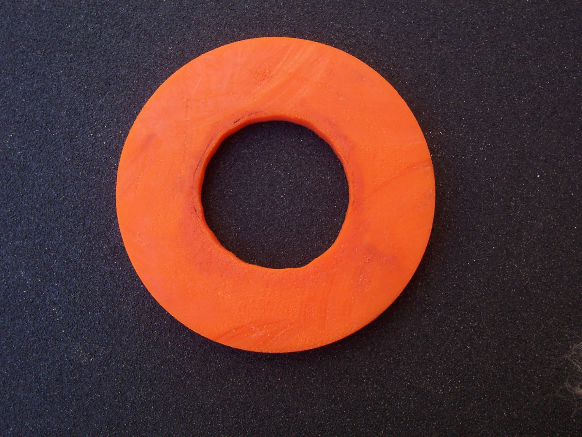

i got tired of that piece of tire mounted to my tire.
so i hit up the urethane supply place for a chunk of 4" O.D. urethane, 80a durometer rod. price: free.
then i went to the metal supply guy and bought a 4" aluminum circle, already cut, for 50 cents.
then i bought a twelve pack and smokes. about 20 bucks.
holesawed, drilled, dremeled, and rebuilt my coaster brake while i was at it.
a few hours later, and the pictures say it all...
(it's too dark, and i've been drinking most of the day, so i haven't tested it yet. i'll let you all know tomorrow...)

gdang beer overhead can make these bikes soooo expensive
Nice job! Question tho - usually I see two bits of tire - one on the outside of the spokes and another inside (makin a spoke sammich), it looks as if you have nothin' between the sprocket and the spokes in this pic... is that an acceptable method?
I would think the angle of the spokes would cause problems w/warpage if they get forced to align flush with the sprocket, particularly as the urethane seems to be firmer than the ol' hunk o'tire bits.
but if it works - so be it
If it's the same bike as in yer avatar - nice job matchin the colors lol

Yeah, I'd put another between the spokes and the sprocket, or you'll be beer bonging away the afternoon doing repairs soon.
there's actually a really thin piece of soft ABS plastic on the sprocket side, between the spokes. i can't put another rag joint in because of chain alignment. there's no spoke wear or nothing.
