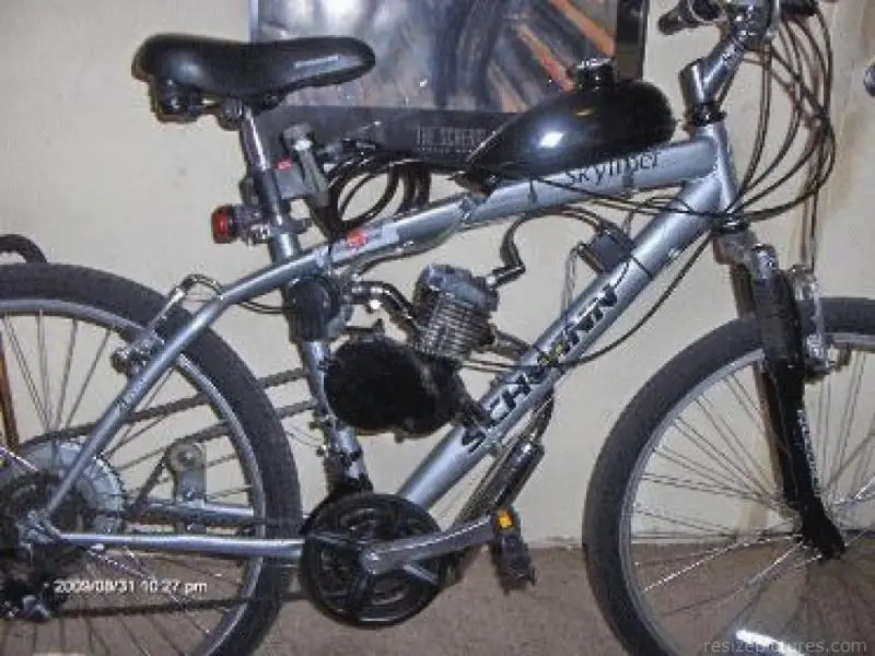

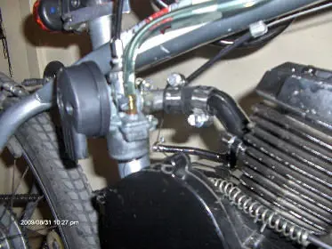

I was wondering.....if anyone else had an issue with a modified intake which was neccessary on a frame such as mine.....so far I've seen one other person whom has the same bike and he also had to stretch the intake out and make it a side draft......off the line it sucks !....however......once you're going....it * Screams *........I've clocked a 34 MPH on a 49cc motor....which I don't think is cool....( blow it up ? )....does anyone think a 45 degree piece of electrical conduit might suffice ....or am I asking for even more issues ?... hit me up y'all ?.....
Thanks,
Salty

I have the same issue with mine, I'm going to be trying a smaller carb off a pocket bike, it's the same bore size but has no float, kinda like a weed eater carb, just waiting for it to show up in the mail.

Old 09-10-2009, 04:13 AM
BarelyAWake's Avatar
BarelyAWake BarelyAWake is online now
Join Date: Jul 2009
Location: Maine
Posts: 5,625
Default Re: Modified intake......
I just posted this in another thread lol but;
I had a very similar problem with carb clearance on my frame, I found simply cutting the intake manifold would allow me to rotate it - changing the angle and canting it to the side. You need be careful however as if it's an aluminum intake, it's nearly a 1/4 inch thick sidewall and if the two halves aren't flush it will interrupt the flow and collect fuel. If it's a steel one, the step is so marginal it really doesn't matter much.
Another concern to be wary of is vibration, should you choose to extend the manifold - be careful to mount it (carb) securely to keep the shaking down, frothed fuel is not going to help performance lol

Old 09-10-2009, 10:21 AM
stv1jzgte stv1jzgte is offline
Join Date: Feb 2009
Location: australia
Posts: 490
Originally Posted by Salty Gator View Post
Can you let me know if it works correctly ?...I swear I'm at my wits end.....off the line the accellaration sucks !.....sometimes I even have to pedal the ***** to keep going.....HELP !
Thanks,
Salty
You want your cake and eat it to? yeh me to. if it goes good up top expect it crap down low. maybe get a smaller rear sprocket.
Old 09-10-2009, 11:08 AM
Salty Gator's Avatar
Salty Gator Salty Gator is offline
Join Date: Aug 2009
Location: Florida
Posts: 674
Talking Re: Modified intake......
*My carburetor is more level than it appears in this pic - my camera was held by a slightly crooked person heh
Dang !......that looks like a solution and I happen to have a spare intake pipe......( I know what I'm going to do today )
Laters,
Salty
