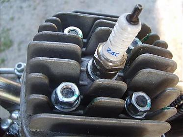

Turns out, it wasn't a gosh darn stripped stud at all ! I have been having enough trouble with the bike, I guess I just assumed the worse, after seeing a lot about stripped head studs on the forums. After actually CHECKING the stud, by moving one of the good bolts to the "problem stud", it was a stripped head bolt, the stud is anchored just fine.
Instead of getting head bolts (couldn't find the size, eventually I will probably order from THATSDAX) I got good quality regular nuts, and put them on with lockwashers. Was able to torque to 15 ft lbs, haven't tried to get to the specified 21 yet, as I don't quite trust it yet.
Came up with a good (I think) idea to monitor the status of the head nuts and studs. I was always "tweaking" them, although the bad bolt was stripped from the beginning I think - tweaking them didn't help.
What I did (pic attached) is make a mark with a sharpie pen on each stud, bolt, and the nearest head fin, all marks lining up. I figure I will be able to tell if a stud is loosening relative to the nut, or the head, or any combination of the possible problems JUST by looking, without having to check with a wrench all the time.
Maybe its a good idea...
