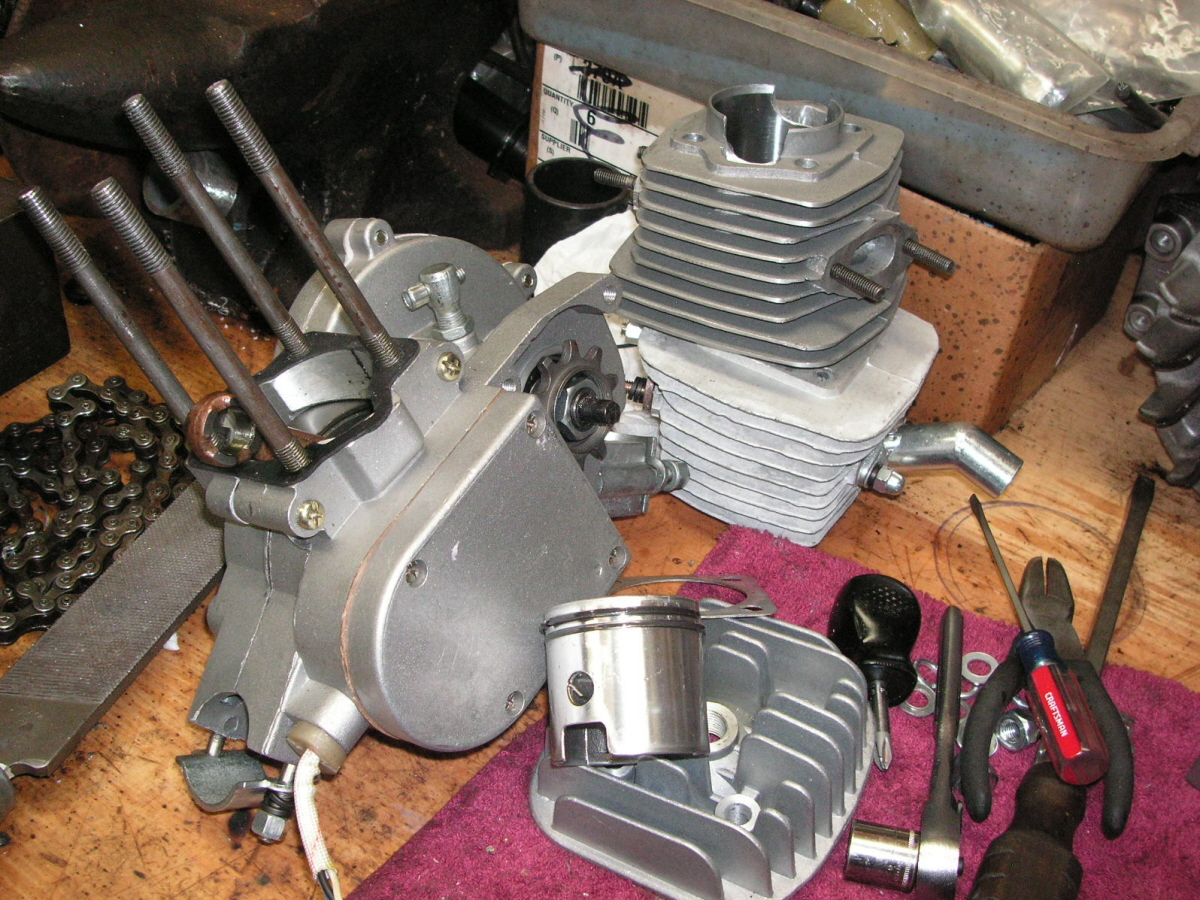

Well I got another one finished today. Ill tell you this, these kits are not the easiest things to get going. First off the sprockets are the worst. I have to carve on them for at least an hour. The one on the engine was so bad the the chain would not come close to running through. The one in the rear just kept derailing till I hit every tooth on the sides so that they would role into the chain. I am getting tired of the head studs being too long. The last engine had the stack of washers and I thought this one would be better, (not). As soon as the engine started it blew the head gasket, the aluminum is so soft that it just pushed it out from under the head, I added another washer to the stack and a new gasket and it runs fine. The last bike I found had 32 spokes so the sprocket would not go on that wheel, and I liked that one. I found a wheel on a Recumbant bike I was building so that is the one on it now. I ran the bike around for a while, it runs good and quiet, but the porting is doing no good with the stock muffler, I will do my mods to that too. I up'd the size of the hole in the carb to a .063 and it seems to work good. It was idling straight away. I like the 41 tooth sprocket that came with the kit, the chrome tank, I think I like too. The clutch handle is the best, I never thought I would like anything better than the Russian one. The throttle and kill switch is better than the last batch of engines I got. As soon as I work out the last of the bugs I am going to paint the thing, I know I said that the last time I built a bike and it is still the same old color. Have fun, Dave

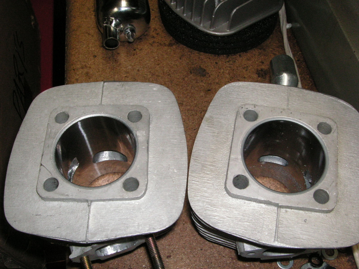

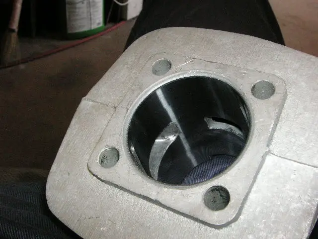

Do you think this barrel has missed a machining operation? To me it looks like they forgot to mill the top, see the rounded over edge! I put it on the block and put the piston to the top and it fall's short. You can see I have been carving on the ports. I widened the transfer and enlarged the exhaust and intake. Well, I don't know what to think about the barrel I will try and put it on the mill and mill the top off. Have fun, Dave
PS: The cylinder I used on the other engine was clean shave'n and the piston was at top. See the piston in the other pic how low the pin location is, (short rod). Also look and the size of the cut outs for the transfer ports, I removed a lot of metal from that barrel (one on top)

I have not run the cylinders from the two Dax engines yet I only have the one I previously ported and it was of another make. I love the way this engine runs so far I only wish it was with the barrel it came with. I don't like the idea I have to machine the top to get it rite. I guess it would work, the main thing is that the rest of the buying public that get this engine would not have the means to do the work it needs to be correct. I know the cost of the engine is kept down by making as many steps easy as they can. The head gasket was pure Aluminum, I used it again with the new barrel but the head studs were too long and the nuts bottomed out and it blew the gasket out immediate. If I had run the engine straight out of the box I can only wonder if it would have worked, the barrel I took off could be taller. I never run the engines out of the box, there are too many things wrong with the engine that just need to be done, it would run but Why. Have fun, Dave

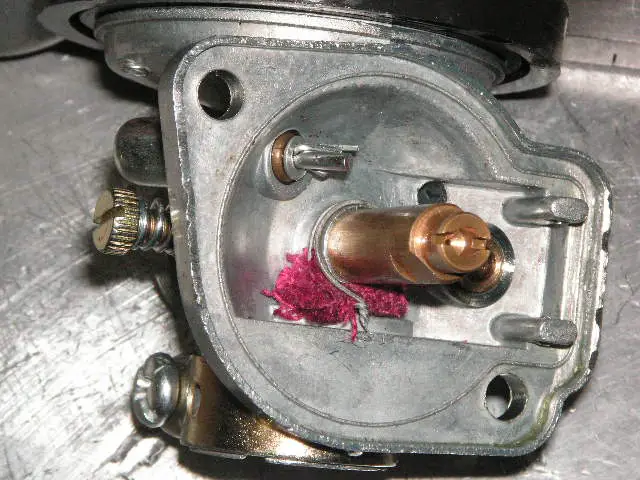

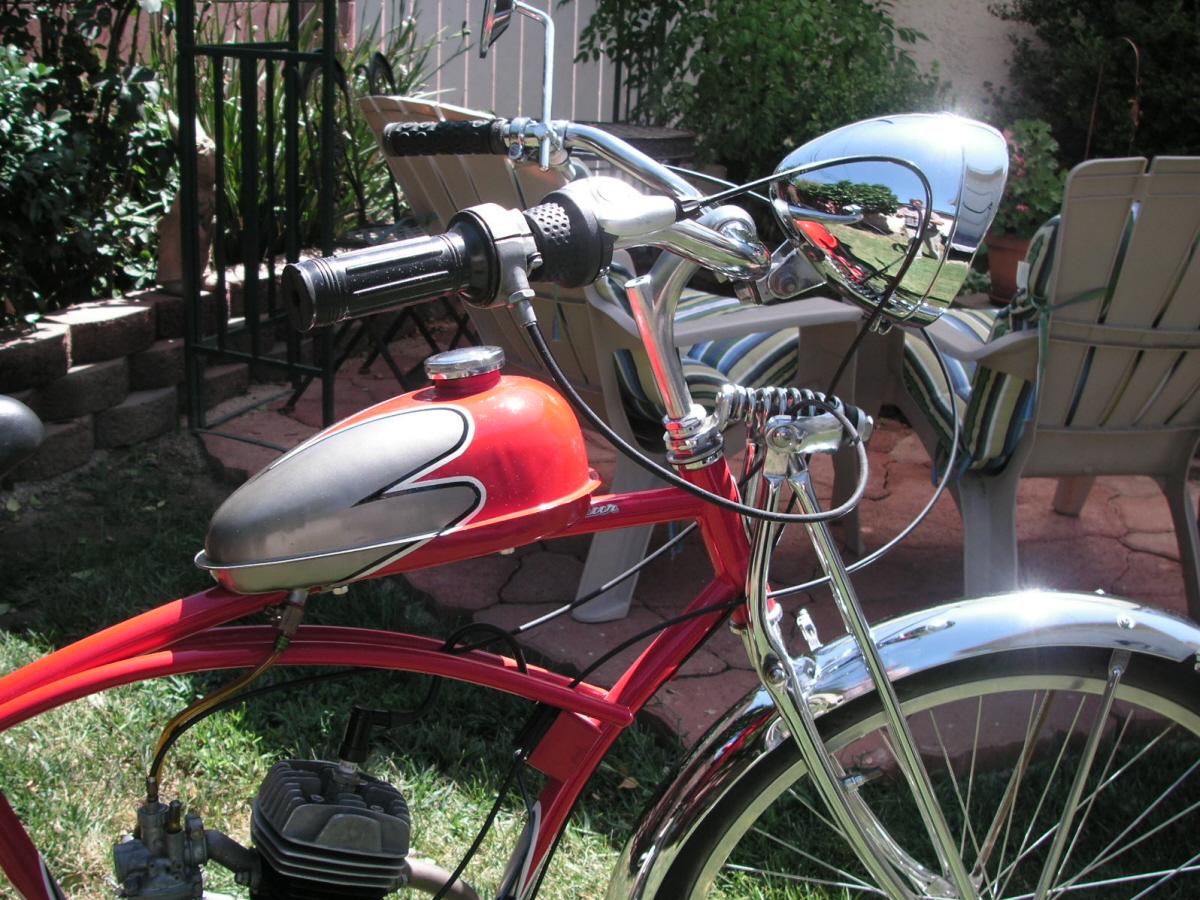

I did a final mod on the carb and I need to post it over at the carb mod thread. I said I put the hole in the carb at .062 and I liked the way it ran but it still needed something, I have a repair manual for the year 1910 It is actually patent leather and looks like a Bible, (don't tell the Bishop, but I can get away with having it in Bible class) I just can't help read when asked. LOL. But one of the things in the book was a section about Wick carburetors. Yea they made them! Well I thought about the Happy carb and thought, if I add a kind of wick under the hole I made in the carb it would add more fuel MIX to the idle. And what do you think! I let the engine idle for ten minutes and not a hiccup. So here is a Pic. Have fun, Dave
PS: I Need to find a way to post YouTube vids so I can show off how well it runs. What do you think of the light on the Schwinn? Cool Yea

Sorry I need to be more clear, I am not talking about the main jet, I am talking about the hole I drill in the body of the carb. I started a thread about a mod to the carb to add fuel for the idle, I added a piece of cotton held in place by a small wire wound around the stem and it holds fuel next to the hole drilled. I need to add a link to the carb, so leave the main jet alone.
