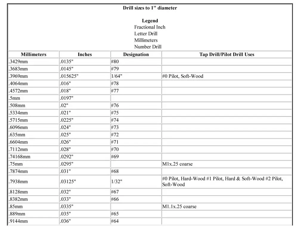

Alright I'm a bit confused on the drill bit vs jet size vs hole diameter. I have read that stock jet is approximately #70 which is approximately 0.7mm= 0.028mm right? I also read that leaning it out makes it a bit smoother and might help my 4 stroking. So if i want to close the hole then I should use a smaller jet- perhaps a 65. So as jet size increases, the hole size increases? I take it this is the opposite since as drill sizes increase the hole is smaller (ex #70 is smaller than #65).
Appreciate the clarification as I am just confused.

ya higher the bit number the smaller the hole i bought my really tiny bits at hobby lobby by going to the #80 i totally got rid of the top end 4 stroking and increased response an acceleration all thru the band. you can google bit size versus bit number and you will find a chart

So bit diameter decreases as # increases. Are Jets the opposite and actually increase in size as the # increases. I want to buy a couple new (smaller) jets but just don't want to go in the wrong direction.

Yes jet size is jet size, a 65 jet is smaller than a 70 jet. But they do correspond to mm. A 65 jet is a .65mm jet and a 70 jet is .70mm.
Here is drill chart for reference.
