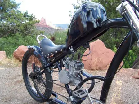

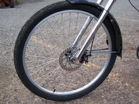

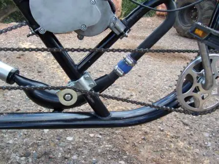

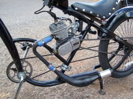

This is my first project. I started with a Micargi Prado Deluxe, which is not intended for a kit like this. I had to add the bar for the front motor mount. Then I ran into all kinds of interesting problems. I used the idler pully that came with the kit on the bicycle chain instead of the motor. I had to fab a spacer for the rear sprocket b/c of the 3" rear tire, I have a couple calls into Manic Mechanic for one of his custom sprockets, hopefully we can make another tested kit for him to offer. I also put an expansion chamber exhaust on. After my first couple tuning test rides I found the need to put a disk brake set up in the front. I also custom made the suspension seat using the spring off a little kids suspension bike, little 10" tonka bike. Top it off with a harley sportster peanut tank and a custom kickstand and there you have it. Im sure I will be upgrading in the near future so I will keep you posted! Opinions and suggestions are always welcome...

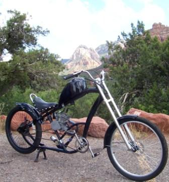

nice ...could we get a full shot?
beware of micargi frames !!!
they are getting a reputation for cracking
just giving you a heads up

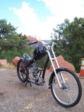

Thanks for the heads up. I thought i had put a full shot up but here ya go. like I said this is my first build so Im workin with a learning curve. I started my build before I found thin site so I've had to do some back tracking.

thanks...looks even better all at once
I like your stand, was it stock ???

No, I made it out of parts I had laying around the shop old sprockets for one

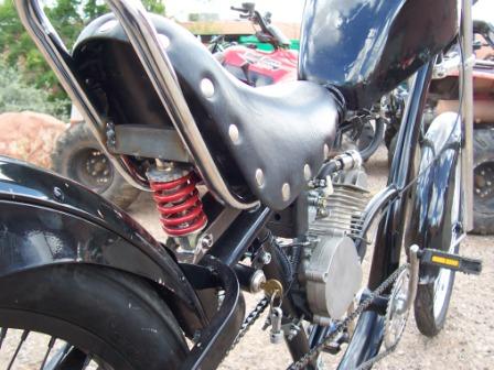

could you show a pic of the adapter for the rear wheel i have the same bike but i had to change the wheel, and how about the engine mounting with the wide back wheel please inform me robertgibbs
