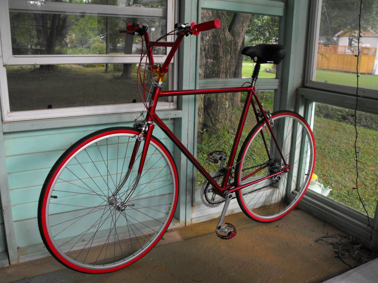

Heres a Schwinn World Traveller I built this summer with an annodized old school BMX stem usually available on bay - the Schwinn has the small 21.1 stem described, which is the size of this MX stem-
I also have one of these on my Peugeot PX10 road bike (circa 1970) which I just shim with some tape- because it replaceda 22.2 stem. Old fart with back troubles who can't ride drop bars anymore, and these BMX bars are lightweight and look great.
