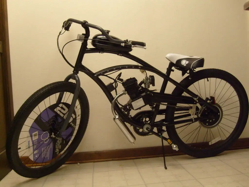

My son and I are on our second build. We decided to put anti vibration motor mounts on it,(similar to those described on this forum). We also fabricated a new Idler mounting bracket.
That said, It runs great. occasionally, when the clutch is released and re-engaged, the chain seems to bind up on the engine sprocket (inside the cover).
I look down the chain ( cheap Chinese chain), it is not exactly straight. it has a few waves in it. Could this be the problem.
As near as I can tell the chain, engine sprocket and wheel sprocket are in-line. Could the engine be moving enough sideways to cause this to happen. It does flex slightly to the sides due to rubber mounts.
Can anyone give a couple of dumb grease monkeys some advice?

also, it's hard to tell from the pictures, but your chain idler pulley looks like it's mounted kinda high. if there's enough slack in the chain, it might be catching an extra tooth on the clutch cog on it's way out towards the rear sprocket (like it wants to keep wrapping around it), and this could cause it to bind. if you could lower it, or mount it somewhere else, it'd put the chain on a different angle

We think we may have figured it out, The engine was a bit out of alignment., So we have it adjusted straight now. and the chain is rolling over much smoother than before, ( up on the stand at least, before it was binding even on the stand.) Tommorow I will find out if that has fixed the problem or not.

I will try to lower the idler. I guess I haven't thought of that. I can remove a link or two and lower it. Either way it shouldn't hurt it (higher or lower).

Think We solved our problems Thanks everyone.
We lowered the idler, shortened the chain, Put on a new chain and re-aligned the engine. One or all of those seemed to work!
