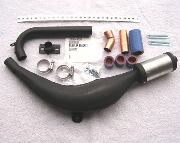

Cheap muffler? I suppose you want an inexpensive tuned pipe... Though I don't much like the Machiavellian method or the various plumbing fixtures, this setup is one of the least expensive (also available in chrome);
Black Expansion Chamber Exhaust Pipe [SBP-ES002] $64.95 Sick Bike Parts

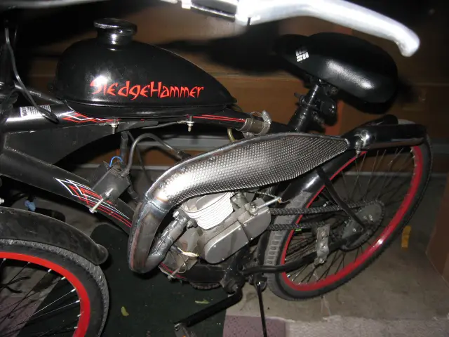

however - for the money, this 'un is soooo sexy;
New SCSW Tuned Pipes for sale! $120 Pipelyne Manufacturing. (408) 279-2307 http://motorbicycling.com/f23/new-sc...-sale-189.html
