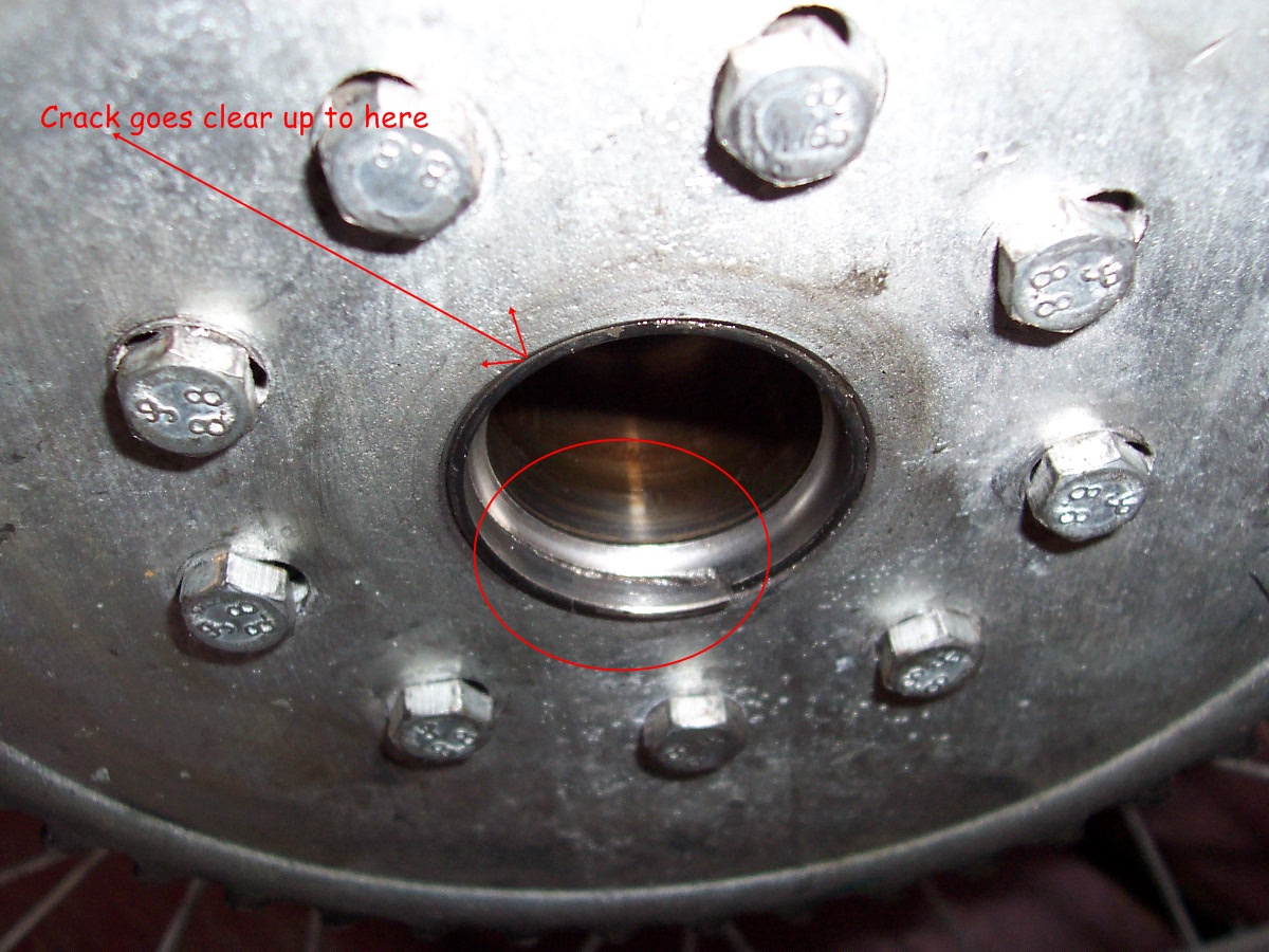

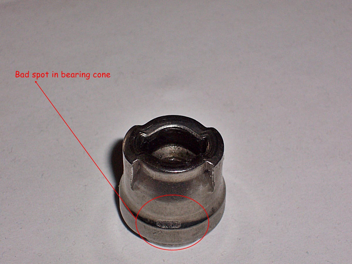

Well after tearing the wheel apart to inspect the carnage I noticed something in the bearing cone that looks to be a casting flaw.
Hub is a write off though
Odd thing is other then the balls falling out of the cage when I pulled everything apart the bearing wasn't all that bad compared to the 1st failure (I expected more after sounding like a blender full of nuts and bolts for 10 miles) 1st time the bearing failed the cage was all sorts of mangled.

The damage I see is called spalling. It happens from lack of lubrication, or the wrong lube for the job. It probibly started during the first failure and got worse from then on.

That bearing cone is indeed spalled. The crack is probably related to the problem, not the cause of it. Lack of lubrication and the bearings being too tight usually causes that.
