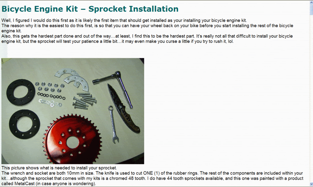

Sprocket Installation - Bicycle Engine Kit
Chris Hill spent a lot of time putting this together and did an awesome job. Great job Chris!
for the rest of the installation process click here Bicycle Engine Kit
