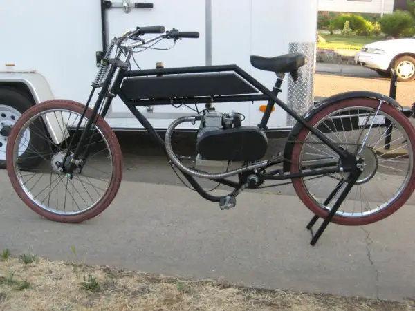

Hi Fred, I do have, in stock, some VERY nice drop-loop motorbike frames with Whizzer motor mounts built right in. Here is a pic of an old prototype that I put an EZ Motorbike system in.
Mike

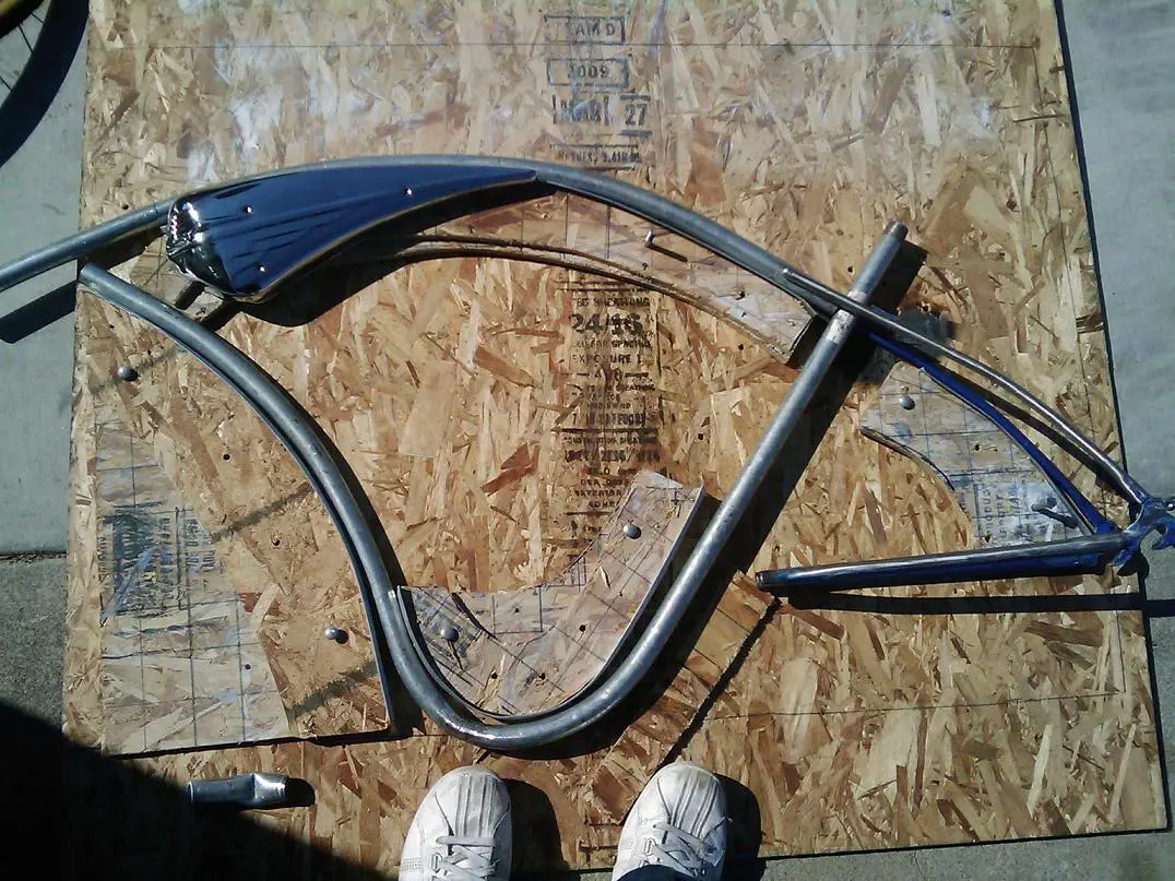

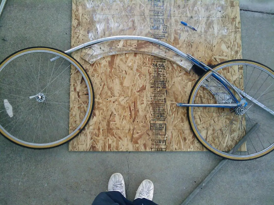

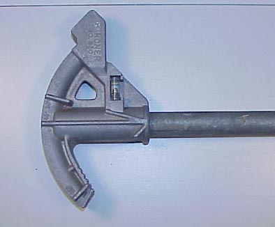

hey im almost done with my bike and i was in the exact same position you are in now, i used galvanized steel, i bought it at the orchard supply down the street because i could not find for the life of me a metal supply shop around my area and when i looked it up it was way too expensive. so i asked the guy that worked there and he told me that it all it was was a steel pipe that had been galvanized (not DOM) and that the only thing to consider was that of you weld galvanized steel it creates a toxic gas but it would be fine if you ground down the area to be welded and welded in an open area, i had no problems whatsoever, and on top of that i used a large 1" conduit pipe bender to bend it, it was hard and required some muscle and help from my friend cuz im pretty skinny but it worked fine and i got some pretty smooth bends believe it or not by bending areas and moving down about 6 inches, you cant tell one bit and best of all i didnt have to buy a $600 pipe roller, i will postt a couple pictures so you can see what i am talking about, oh ya and dont use conduit, it wont work, trust me i considered it before i found the steel and they r pretty close in price, they were actually right next to eachother in the aisle, well i hope this helped you
